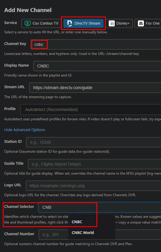

It's the field labeled Channel Selector

I tried changing the stream source to cnbc.com and it wouldn't make a difference. The channel would still open in Directv.
I did a lot of work this morning, switching from docker to native windows installation and back. I have Prismcast mostly working with more really strange behavior. Now, instead of every Prismcast channel tuning to MS NOW, Prismcast will replace the TVE channels I have with Prismcast's (weird, right?) So what I've done is disabled those channels in Prismcast and the TVE channels return to my guide. Now Prismcast channels with Directv as stream source will tune correctly.

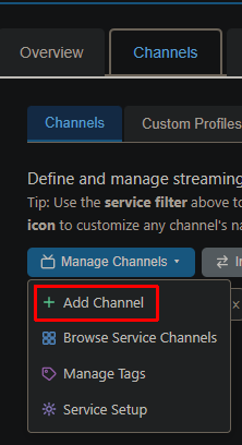

I started playing with this, and when I click on the Add Channel nothing happens. Any idea why that would be?

Works for me using Brave, Edge and Firefox.

It was the browser version. Thanks!
