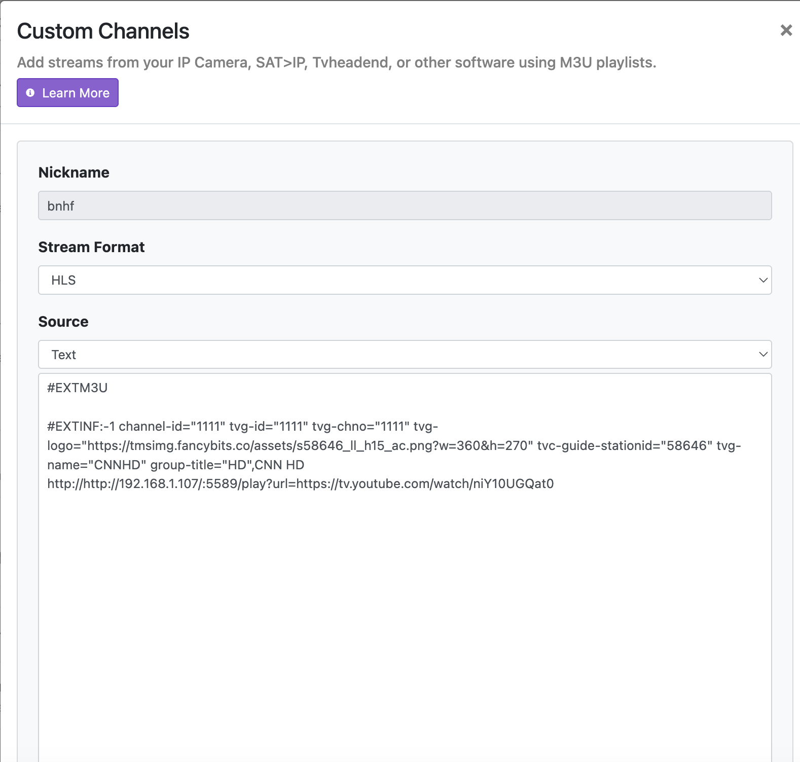

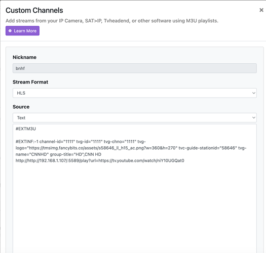

This is the panel for the channel that contains the code you sent. Did I set it correctly? I cannot find any channels that match the "1111" value that the "new" CNN channel should be presenting as, but I filter for any channels that are a part of the bnhf source I created today. There is this one, and it has a channel number of 9181. I have never seen that number before, and otherwise see no CNN channel with the number 1111. I feel like you are giving me sound instructions but I may be missing something.

The URL, where you modified it for your Mac Mini's IP, has http:// entered twice. Fix that, and reload the M3U.
This shows that same problem mentioned above.
/ before the port also
Yes, quite right, multiple editing problems.
Don't worry too much about the channel number right now, whatever CDVR assigns is fine. Use 9181, if that's what shows when you look at the bnhf source in the WebUI. Once you get the editing sorted out, please tune on a client (not via the WebUI now), and submit both logs if there's a failure.
Oops about the malformed ULR and port. Fixed, reloaded and restarted. Same. Argh.
