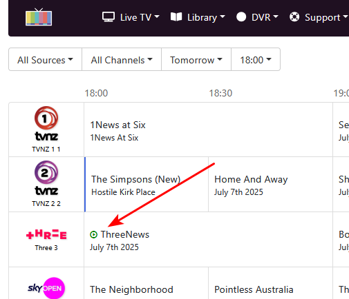

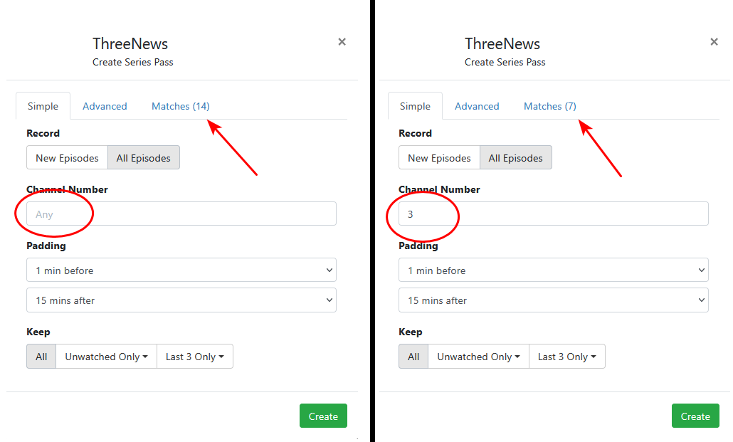

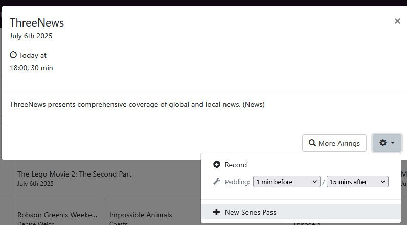

When I set up a series pass from the web client, I select all episodes and manually enter the channel number. That removes all recordings from +1/timeshift channels that I have. You will note that the series pass can see that there are future recordings on upcomming days:

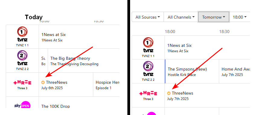

I check the guide and see that the recordings for today and tomorrow are scheduled:

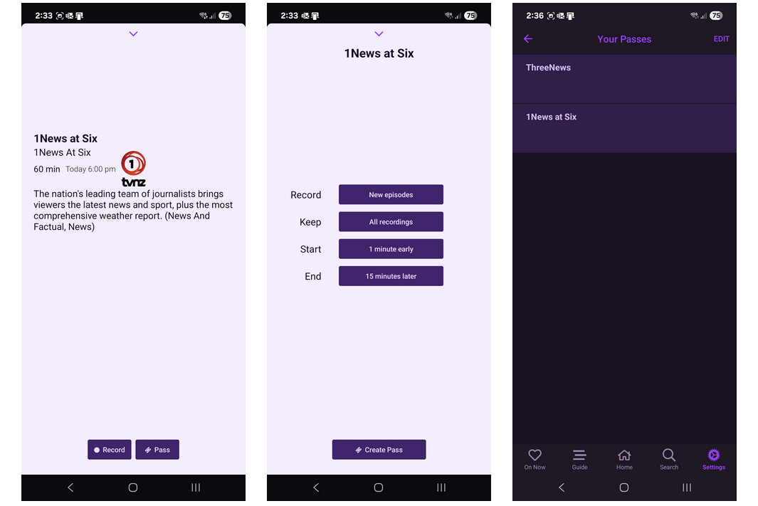

For argument's sake, I also set up a recording from an Android client for the 6pm news on channel 1. With this I don't have to select the channel number which is good. I still select to record new episodes. Once created I can see both the passes set up from web and client:

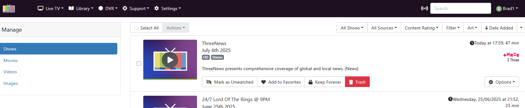

After the episodes finish, I can see the recordings for channel 3 but the one I set up via the Android app didn't record at all:

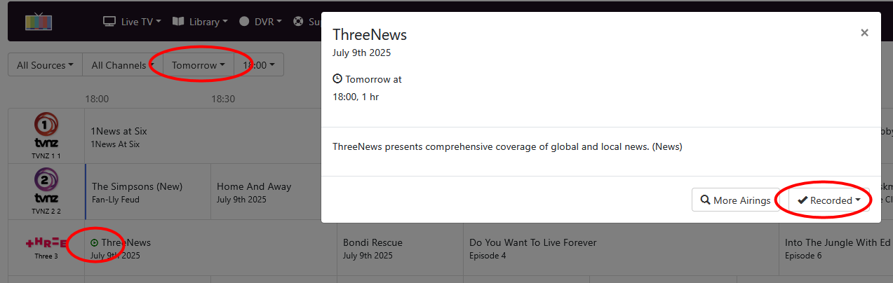

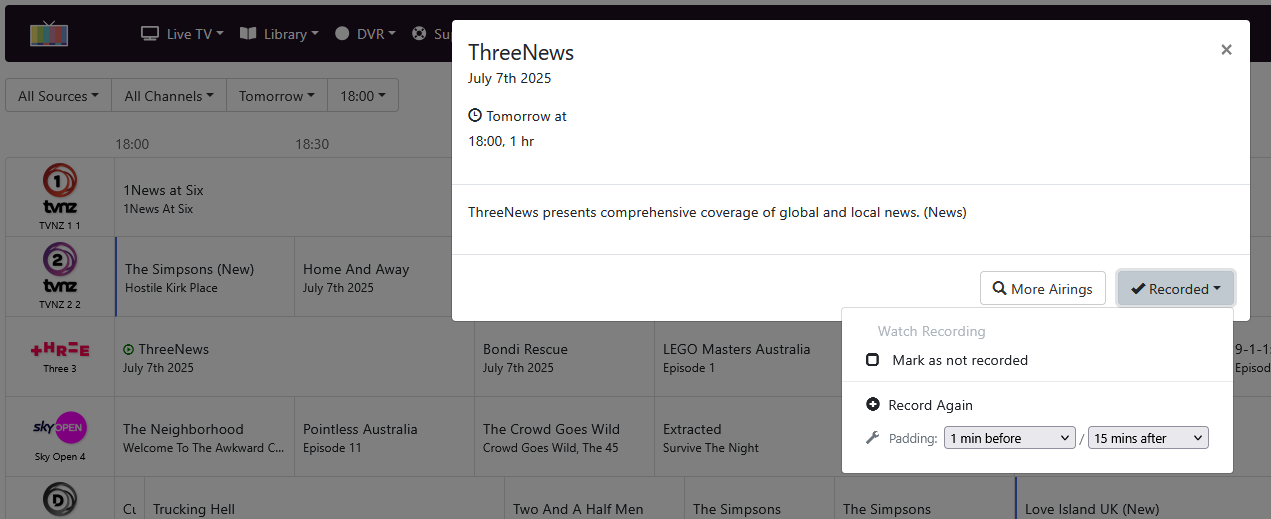

If I now go forward in the guide to tomorrow at 6pm, it shows the Three News is 'already recorded':
The fact that channel 1 didn't record at 6pm does seem to be a separate problem, but the main one I have is that the first episode records when all the rest don't, they show 'recorded'

Most likely culprit: incomplete guide data. Whichever XMLTV provider you are using is not marking each airing of that program with a unique ID, therefore Channels believes that every airing is the same. Additional airings beyond the first are not recorded, because Channels thinks it has already been recorded.
There isn't really a good answer, and maybe somebody will have a clever workaround, but I haven't had my coffee yet.
The “proper” solution is to give Channels guide data that more fully describes the content, such as giving each new airing its own unique identifier.

What do you see if you click the blue Matches(7)?

It's because you selected New only and the guide data doesn't have the airing marked as New.
As far as your Three News issue, racameron is correct in that your XMLTV EPG (XMLTV-MyMainStreaming) for that custom M3U source (M3U-MyMainStreaming) isn't using unique identifiers for each airing, so they all look like the same episode to Channels DVR (generic airing listings).

IPTV editor m3u is the source. If I click the blue matches(7) it shows all upcoming episodes for the next seven days. So it knows before recording the first one that there are future episodes, but after the first one records it thinks that all the others listed are already recorded.
This is where the problem is odd, it knows before recording there are future episodes on multiple days but after first recording it thinks every future episode is already recorded.
Please show the schedule. It may think the future airings are the same show
Yes that's the problem, it thinks future, new airings are already recorded:

The issue is that your third party guide data isn’t providing each airing with a unique identifier. So Channels DVR Server thinks it has already recorded it, and won’t record the other airings.
This is core to the recording engine and without proper guide data, it won’t record any additional airings as it thinks they are all the same ones.
As maddox points out every broadcast appears to be the same one due to the guide. My suggestion to record All Episodes will overwrite the previous one when i records. This appears to be news broadcasts so it may may be acceptable. There are some third party addons to Channels that might help you with this. Stream Link Manager has a feature to address some mu3 issues. I have not used that feature. You will need to investigate
