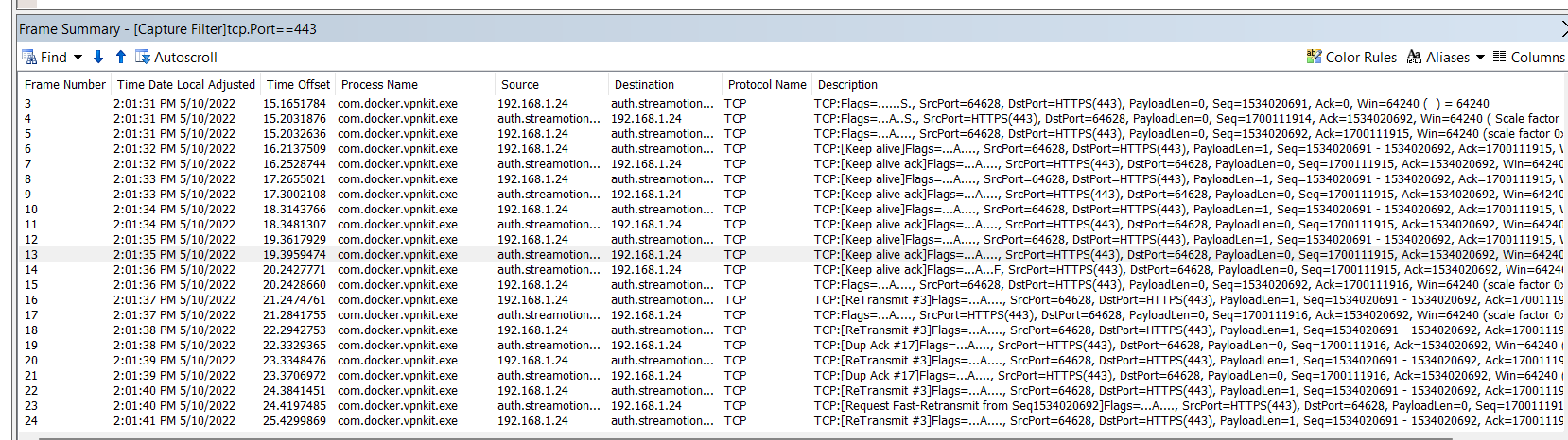

I've just discovered this wonderful setup! I got it running last night and at first it worked fine. But about 1 hour later it started failing. I thought it was an issue with my DNS server, so I rebooted it, and it started working again.
However this morning it is failing again, I've confirmed that DNS is working correctly. I assume the container uses the same DNS settings as my windows host? My password does have an "!" in it, so I've added the escape character (although it worked without it as well).
Any help would be appreciated!
EDIT: I've done a bit more digging, and as the errors below seem to suggest, the connection is timing out. I've run a network capture and I can see that it is going to the correct IP address, but it is having connection issues, the 3-way tcp handshake completes but then I'm seeing retransmits and Dup Acks - I'm not sure why it's being so flaky.

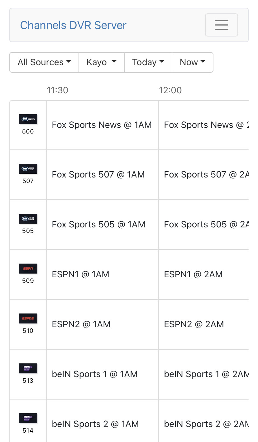

Guide data seems to be missing as of last few days?
Or is it just me?
