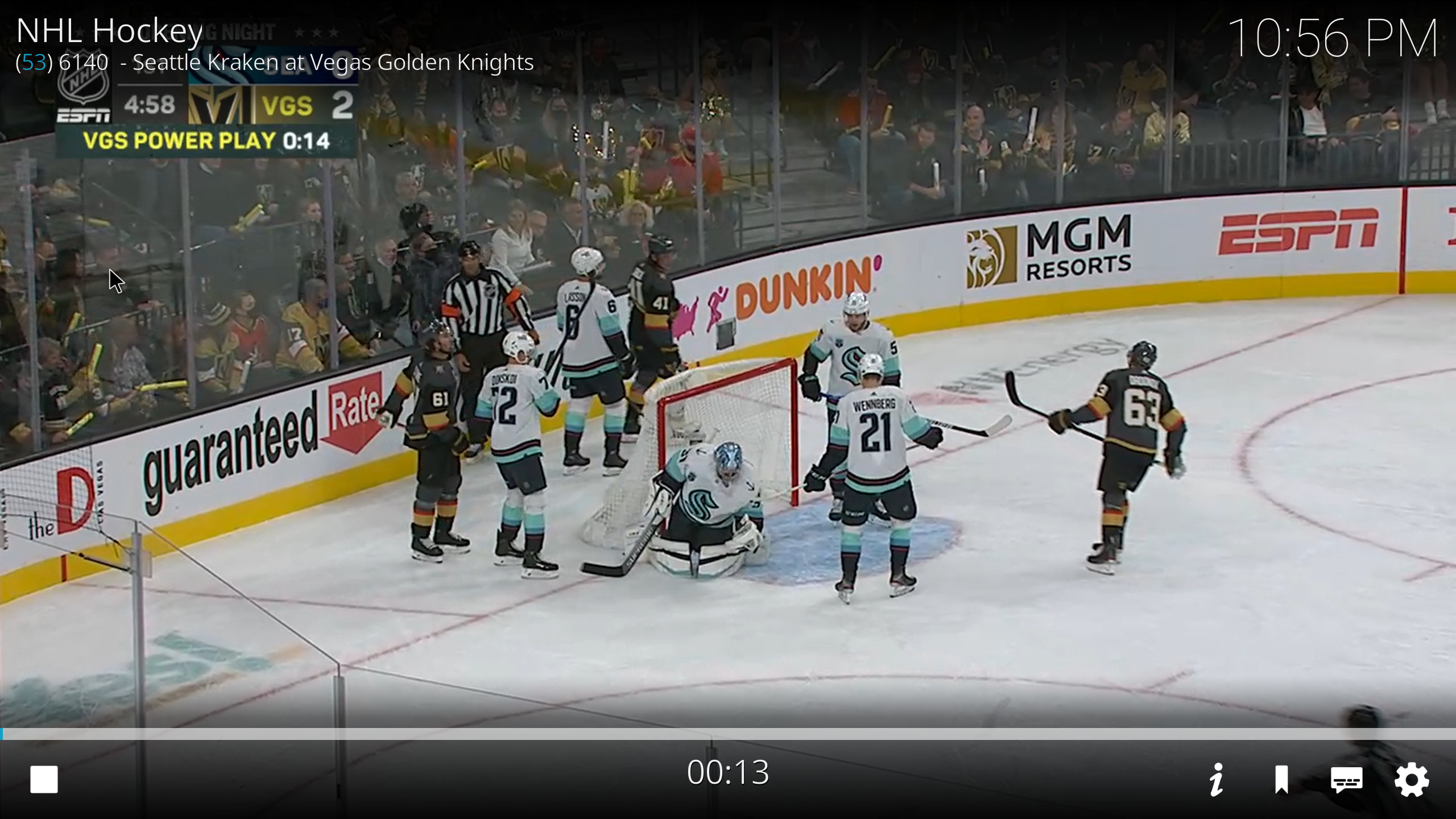

Timeshifting live recordings will hopefully be added. Here is an example I posted last week. This is with NextPVR. It doesn't seem that Kodi will limit this so hopefully this feature can be added.
