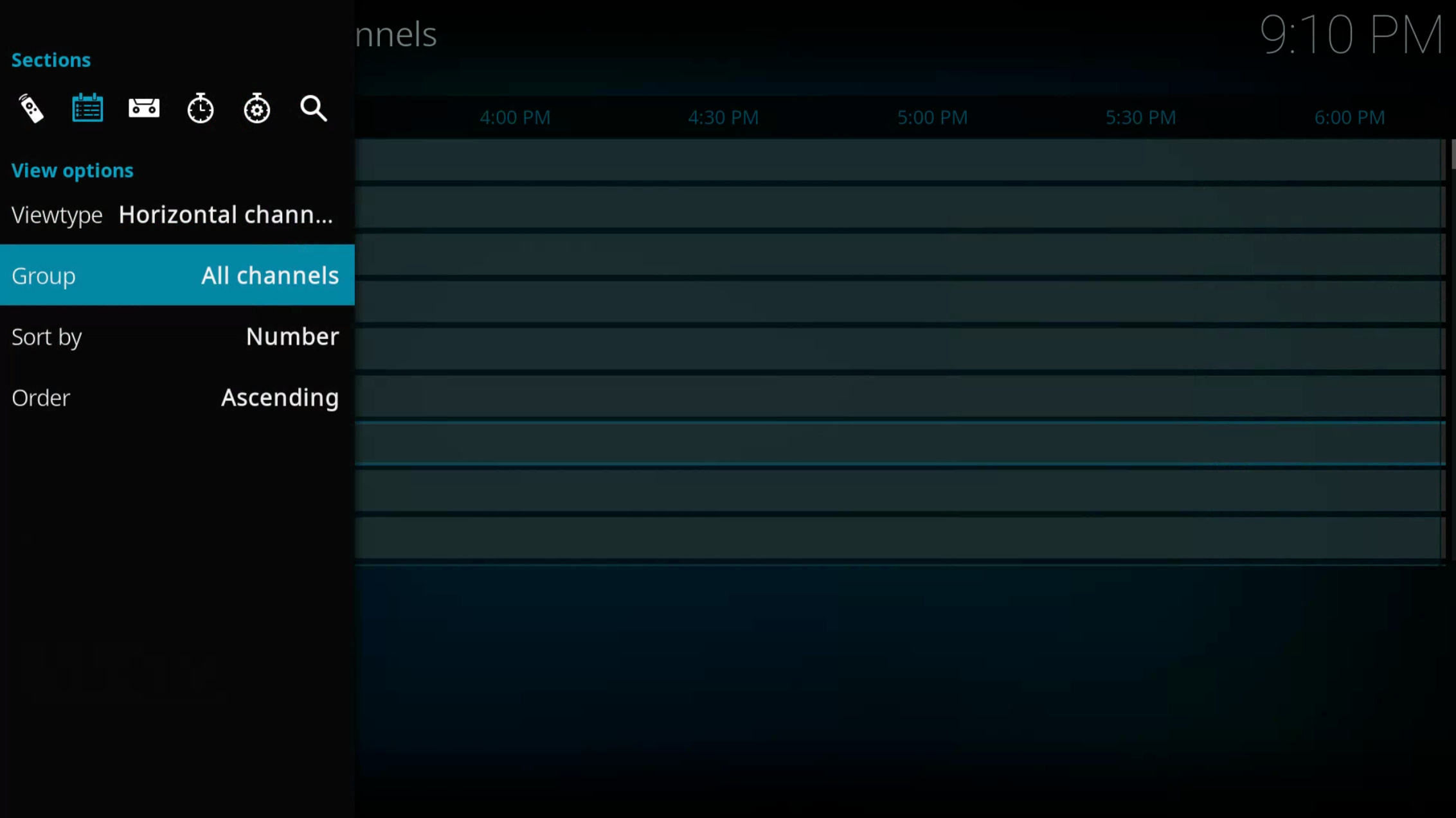

Yeah, it varies from skin to skin, some show the icons on the guide some show the details above/below the guide or not at all, some show the channel icon beside the details and others show the episode thumbnail. I think I prefer the default skin, just wish it would show the channel icons on the guide. The skin in the image is Embuary
You can also narrow the guide by category, the same as the Channels apps, it just isn't as easy to get to...
Might be best to pull in earlier data, as you can see above, by default it will show up to a day behind and that ends up blank. The odd thing is when you change that setting to 0 days behind it doesn't want to show even the last 1/2 hour, which makes the guide hard to read.
Do you see the HD and Favorites categories?
