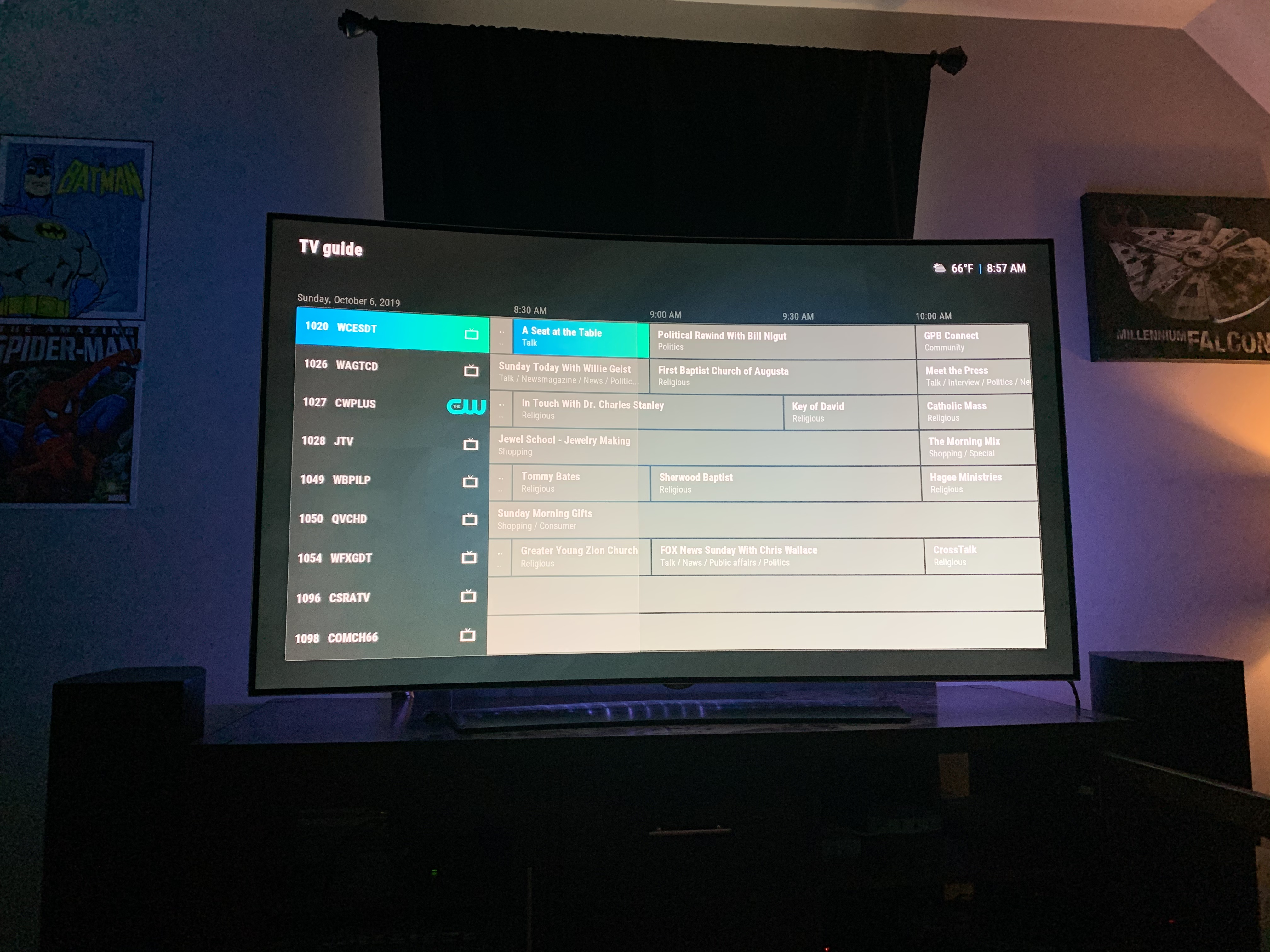

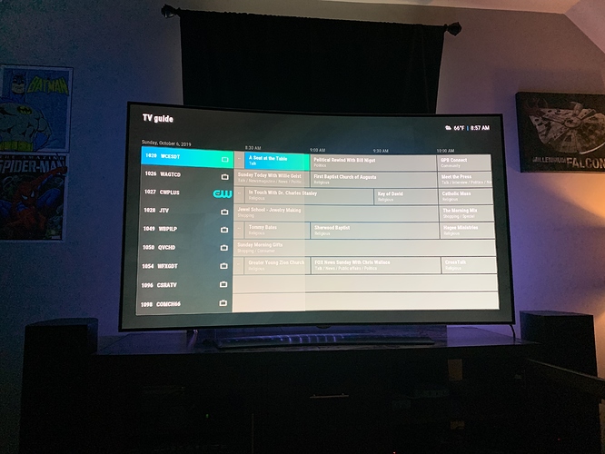

Worked! :slight_smile:
Automatically detecting channels isn’t working for some reason, but adding in the IP for my server works. One main issue is no icons for a lot of channels.
Update: Icons are showing up now.
Cool! What skin is that?
