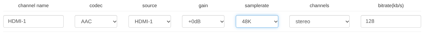

Hi, wondering if anyone could help. I've had the Enc1Pro for a few months now and unfortunately I'm still having a couple of issues.
The first issue that no matter what I do, my audio output is stuck at 32kbps despite it being set to 320kbps in the dashboard.
The Second issue im hoping may fix the first but unfortunately the encoder will not upgrade to the latest update "update_enc1pro_20250630" it is stuck at 0% when trying to update directly on the dashboard and if I try to download the update to my desktop and upload it to the encoder it just returns a 500 internal error.
I have linked a post that one of the devs made on the forum with my settings from when I emailed them directly asking for help on the audio issues but unfortunately there's been no response.
Any help would be appreciated.
I didn't see a change when I updated mine. Or maybe I just had it at defaults...
Thanks for posting when the new firmware's are out, I have to change some firewall rules to get the updates.
Have you tried using CBR instead of VBR? Also make sure your audio output on your device is set to stereo manually.
Thanks for the response, Ive changed the encoding to CBR and tried changing from AAC to MPEG2 and MP3 but it still sounds bad and I also have a "Bits per sample" of 32 but it says the bitrate is 320kbps. It still sounds like voices are spoken through a clipping speaker. I've checked my device settings that are being streamed and its stereo audio and I've tried both PCM and RAW audio but it sounds the same unfortunately.

@SF10 , I'm not much for troubleshooting of this kind. But, I offer that I use these audio settings without problem. I wonder if it is possible that you may have a bad HDMI cable or loose connection between the tuner and LinkPi.
Thanks for the advice. I've just tried these settings exactly including the 128kbps and when I pull up the codec details on VLC and it's still reporting 32 bits per sample. I'm stumped as to what has caused it. next is to replace all the cables but I don't think this is the issue as its worked fine with the uRay Coder...
