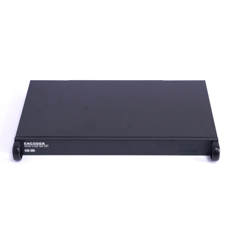

In an earlier post, you were joining us using the Link Pi Enc8 encoder. How’s it working for you? I have the 5 port version but am considering upgrading to the 8 port instead of running two 5 port encoders.
8 source inputs for $450, that's impressive if this is the device you are referring to:
https://www.amazon.com/dp/B0DRP4F3ZB
Yep. I was looking to get another 5 port and the 8 port pop’d up. If I get the 8 port, I'd only have to run 1 encoder and have a backup. For a little over $100 more, it's enticing.
if you don't need a box, bare board is only 399! that's only $50 per tuner :thinking:
This is a bit cheaper. Sometimes they also have coupons if you sign up for an account.
FWIW, ENC5 HDMI inputs are 4k30, ENC8 HDMI inputs are 1080P60.
