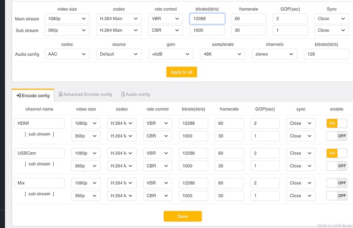

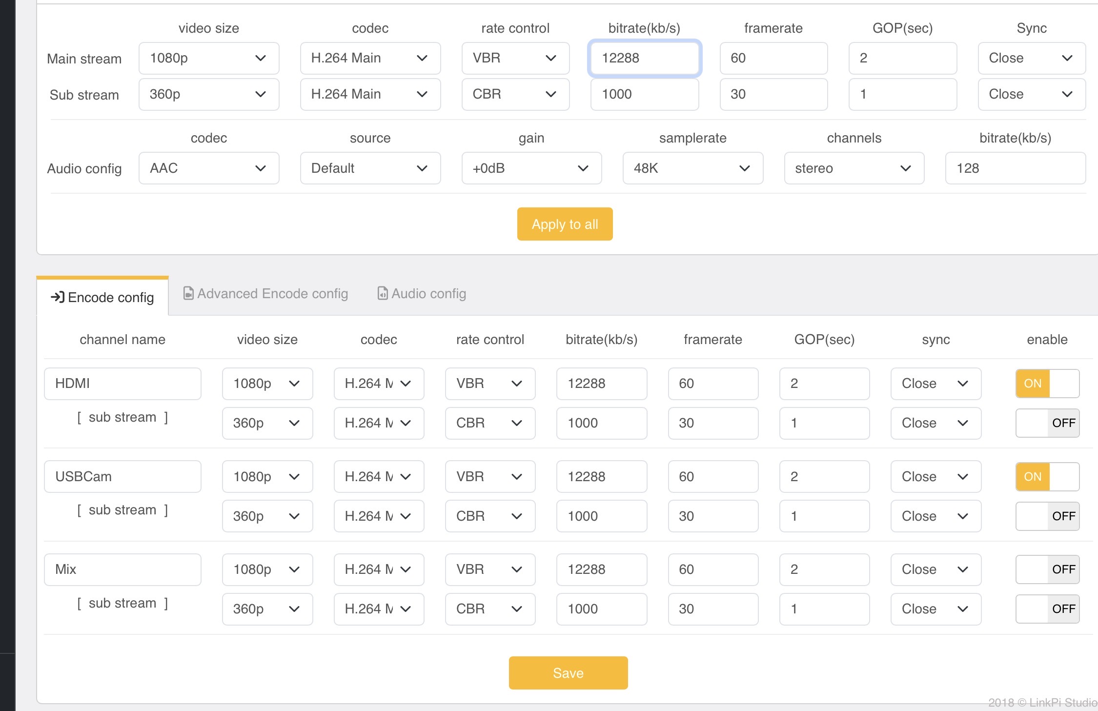

Is there a consensus what bitrates and other settings to use? I changed mine to H.264.main, upped my GOP from 1 to 2, changed from CBR to VBR. But im still seeing the same issue.
I even disabled all the subchannels, my mix output, etc to reduce cpu load.
And it “seems” to only occur on this one show. When i re record a repeat, i see the same pixalation issue, but at different random times.
Any ideas folks?

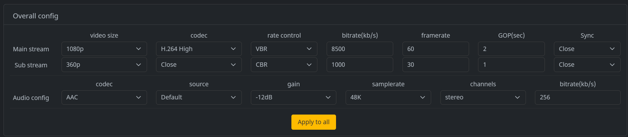

This is my setup. Ignore the gain, my Ospreys are loud!

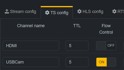

also I just checked and noticed one of the times I changed usb encoders, TS Config - flow control turned itself on.
Screenshot 2026-08-12 164038
my understanding is we don't want the flow control but that is based on tcp/ip flow control so hopefully someone can enlighten if there's any difference with TS flow control.

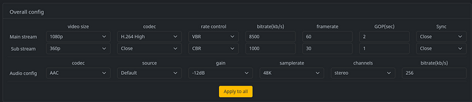

In the past I recall the suggestion was to use AVBR as opposed to VBR. I bet you are using VBR for a reason... Care to share your findings?
Just the opposite in fact:
Check out the 2025 edit in this post. Also, H.265 is fine to use in ah4c, and also in ADBTuner now.
Thank you for the quick response, I have updated my settings. I have not had any issues to date using ADBTuner but I am about to add 5 more inputs so I wanted to see what the latest was.
