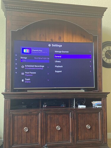

Really quick…..is there a better client that doesn’t have the memory limitation for standard build to handle the buffer situation?
Go with appletv. Better in all respects includingmore buffer than you will ever need.
Before the android lovers pounce on me, I am an android guy that owns 3 appletvs and everyone in my house carries an android phone. Apple tv is the only apple devices that i have and they are far superior in every way.
