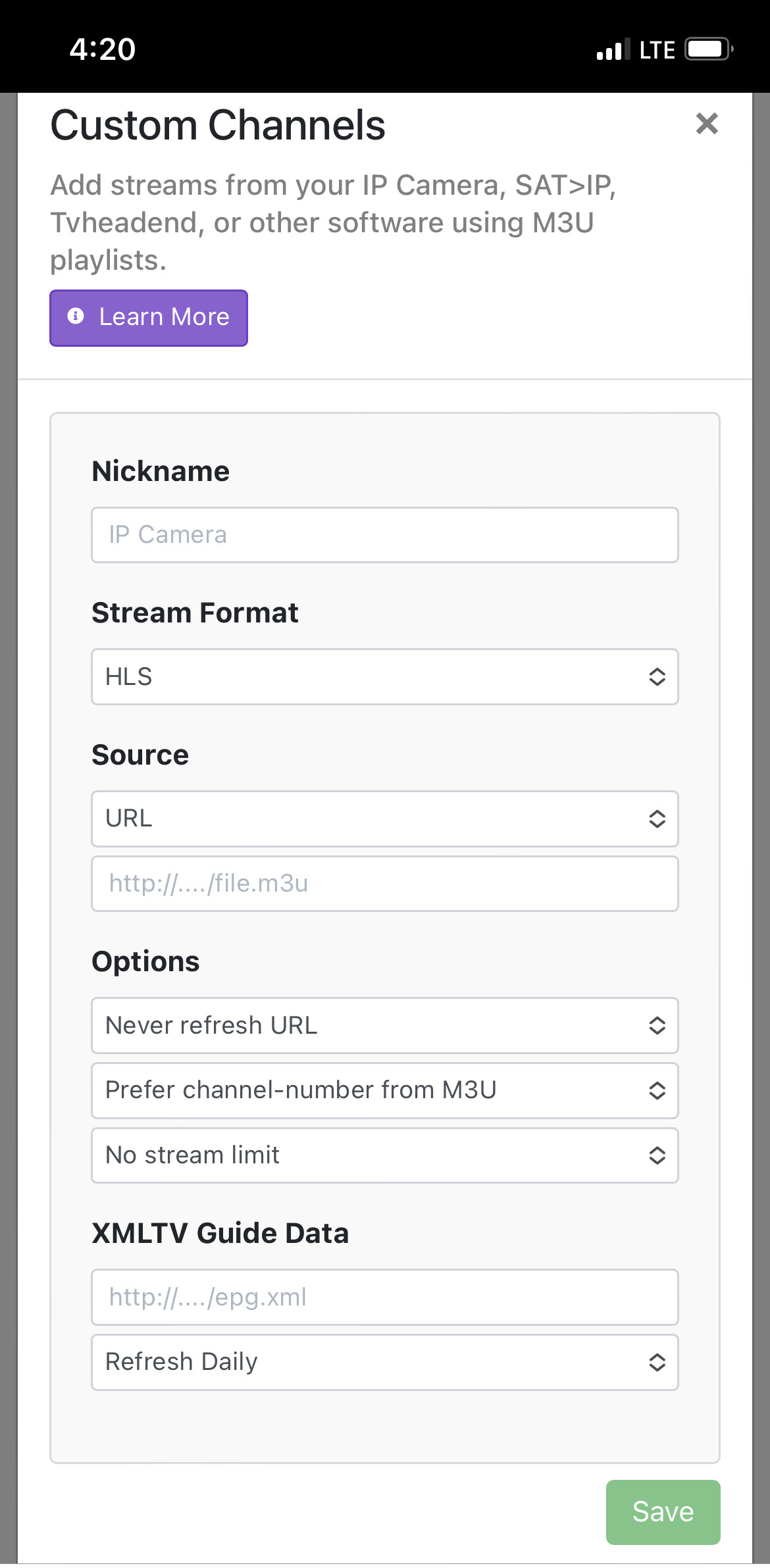

Can someone possibly share a screenshot of a custom channel setup with a channels m3u? I found an earlier post that gave an example of the url but I’m not sure how to incorporate it.

Of someone could share a screenshot with their ip redacted like this it would be helpful

Ok perfect that url is what I was looking for. And that will be used as url under source and I won’t be using text option correct?
