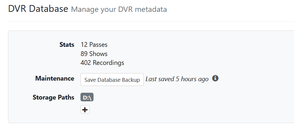

@mjbomar - using the DVR server web interface you should be able to specify where you want the DVR to store or find recordings. Using Windows at one time I was recording to my "C:" drive and then sometimes moving recordings to my "D:" drive - under a mirrored folder structure.
Look for this area of the DVR interface and just add whatever Storage Paths you may need.
