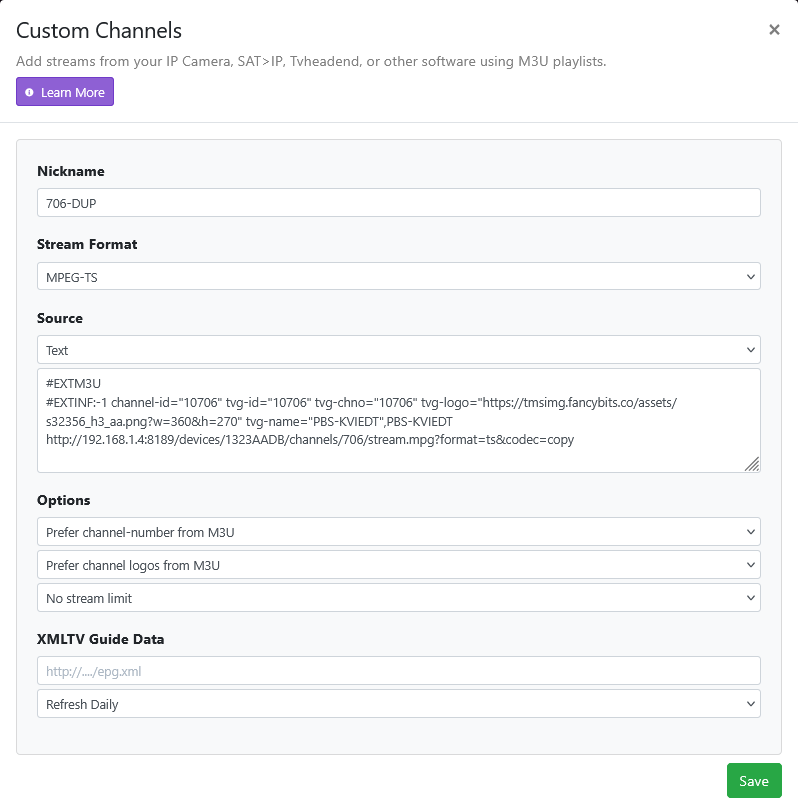

Create a Custom M3U Source with no guide data (it will use placeholders) that points to your source device channel to record. Then create your pass using that custom channel.
Example using my HDHR Prime tuner source channel 706
I export the M3U for my HDHR Prime source and edit it
#EXTINF:-1 channel-id="706" tvg-id="706" tvg-chno="706" tvg-logo="https://tmsimg.fancybits.co/assets/s32356_h3_aa.png?w=360&h=270" tvc-guide-stationid="34197" tvg-name="KVIEDT" group-title="Favorites",PBS
http://192.168.1.4:8189/devices/1323AADB/channels/706/stream.mpg?format=ts&codec=copy
to use as a new custom M3U source. The existing one is still ch706, the new one is ch10706.
#EXTM3U
#EXTINF:-1 channel-id="10706" tvg-id="10706" tvg-chno="10706" tvg-logo="https://tmsimg.fancybits.co/assets/s32356_h3_aa.png?w=360&h=270" tvg-name="PBS-KVIEDT",PBS-KVIEDT
If you want something other than 1 hour placeholders you can set that
https://getchannels.com/docs/channels-dvr-server/how-to/custom-channels/#automatic-placeholders
If you want to duplicate multiple channels, just add those lines to the custom M3U Text.

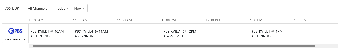

Using one hour placeholders on my channel 10706, the SeriesID is placeholder/channel/time

I'm sure the reason for that is so you can create a pass with SeriesID == placeholder/10706/6PM to record channel 10706 everyday from 6PM-7PM.
