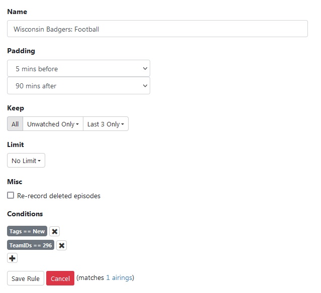

Season pass settings:
When I got home, I checked Channels DVR and it wasn't recording. It indicated some kind of authentication problem. Then the clock hit 5pm and I could no longer see the entry in the guide on Spectrum TVE 6199. I rescanned the channel and it mysteriously started recording after 5pm. I lost nearly all of the game.

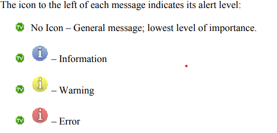

I agree better reporting of missed recordings is needed.. i should not have to look through a log in WebUI to find why a recording failed.. SageTV has Instant messages that tells you why a recording failed as soon as you start a client.
