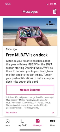

this looks like good news for those of us waiting on t-mo...
