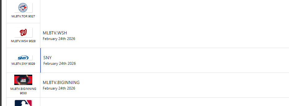

Long story short I was able to search for mlbserver within the docker registry and found "tonywagner-mlbserver1:. used an AI prompt (perplexity) to walk me thru how to configure it and I can stream SNY to my channels DVR! But I can't get the actual SNY guide to work. All the guide shows is 34 channels (all the teams plus a few others for mlb). For each team it shows just a straight line across. How to I get the actual guide for SNY programming so I can schedule recordings for Mets games and other SNY shows?

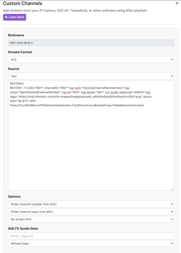

Here is the setup for the custom source in channels:
Here is what the guide looks like:
Here is how I interpreted your instructions for the source text by updating the bolded text:
#EXTM3U
#EXTINF:-1 CUID="SNY" channelID="SNY" tvg-num="9029" tvg-chno="9029" tvg-id="SNY" tvg-name="SNY" tvc-guide-stationid="49603" tvg-logo="https://img.mlbstatic.com/mlb-images/image/upload/t_w640/mlb/le5jifzo6oylxtnuf0m1.png" group-title="MLBTV",SNY
https://192.168.10.10:9999/stream.m3u8?event=sny&mediaType=Video&resolution=best
Something is still off since the SNY guide isn't updating. Any ideas?

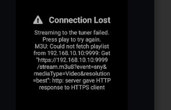

hold on. I had to clear out the XML guide data field. Once I did that, the guide updated. Now the guide looks good and I scheduled a recording for a mets game happening right now. But - the stream is no longer working, Getting this error
try the url in the m3u as http:// instead of https:// ?
Good catch. That's my bad on the original instructions. I was using a reverse proxy for mine and didn't even think about that.
@rss7 do what @KineticMan said and it should work.
