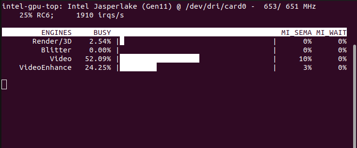

I just upgraded my kernel to 5.16 and that brought back the hardware transcoding option. I'm going to test this to see how many transcodes I can get before it breaks :slight_smile:
This is with 3 transcodes going from Live TV channels down to 4MB. Does this look right?
I will say that loading of TVE channels is almost instant on the Beelink. When running on my Synology it can take up to 5-7 seconds to load.

echo "options i915 enable_guc=2" | sudo tee /etc/modprobe.d/i915.conf
Thanks! That resolved the issue.
