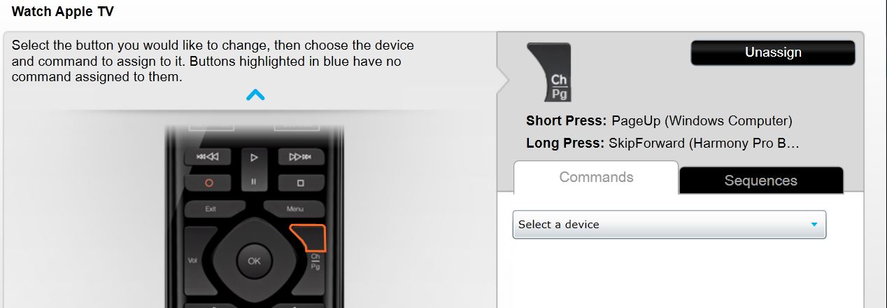

Any advice? I'm using Harmony Elite. I set up a dummy Windows keyboard. I can the F1-F4, P key to work (really handy to jump PIP). But I cannot get the Channel Up/Down to work. At first I had it programmed to the CH> CH> keys, but then realized that skips two channels. Then I found this post, programmed to page up, page down, and now I get nothing.

Any idea why the F1-F4 keys work fine on my harmony, but the page up/page down commands don't work? Also, the P command on the center button works fine too!

I have two AppleTV's sharing the same (new, excellent) Channel Categories, one category of which I use to acts as âfavorites.â On AppleTV #1, my Harmony 650's channel buttons allow me to channel surf because the Sony TV there has robust CEC support. On AppleTV #2 my new Harmony Companion was programmed to use this Windows PC as a virtual device, and it's working pretty well, all things considered. These commands are set up as PageUp and PageDown as instructed here. But when channel surfing live channels, the order wasn't the same, and I thought it had something to do with how I'd set up and organized my favorites. I was looking around trying to figure out how to reorganize them. I checked under Settings > Manage Sources > Lineup Order, but changes there didn't have any impact, and I'm confused now by what "Default" means in this context. Then I played around inside Settings > General > LiveTV > Channel Surfing but whatever selections I tried, the actual navigation behavior still wasn't matching. I was stumped and thinking about how to best ask the question here.
But that's what's exactly what's happening, Channel Up and Channel Down is skipping two channels with every button press instead of just one. That's exactly the pattern I am seeing. I can stop digging for some other explanation. Hopefully this can be fixed somehow? And thanks for helping preserve my sanity!
I can't even get CH > CH < to skip ahead two channels anymore. F1-F4 work fine, but can't figure out why page > page < does not.
I used the skip forward and skip back for the CH up & CH down.

I could have sworn I tried that previously and it didn't work. I just tried again though and this time it's working, changing one channel at a time. Perfect! Thanks.
Skip forward/backward is working for me again. I don't watch a lot of live tv, and don't really channel surf, but it's nice to have when you want it.
