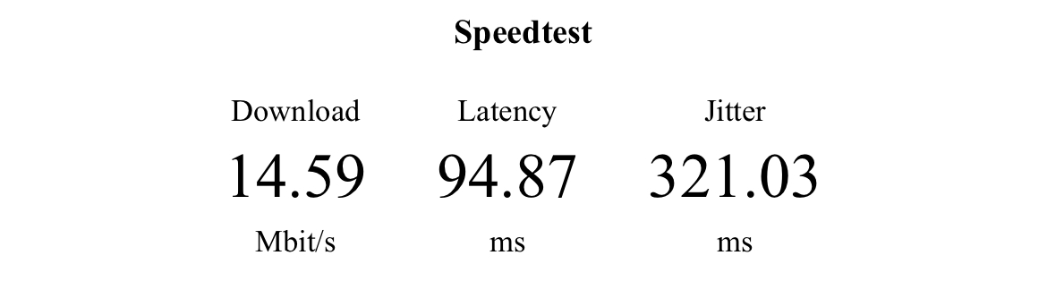

If you go to https://my.channelsdvr.net/speedtest remotely what sort of speeds are you seeing?

This is from my iphone. The other client is my mom's ATV4K
That Jitter definitely looks high, but I wouldn’t expect it to be fatal. Do you have any issues using your DVR from within your house?
