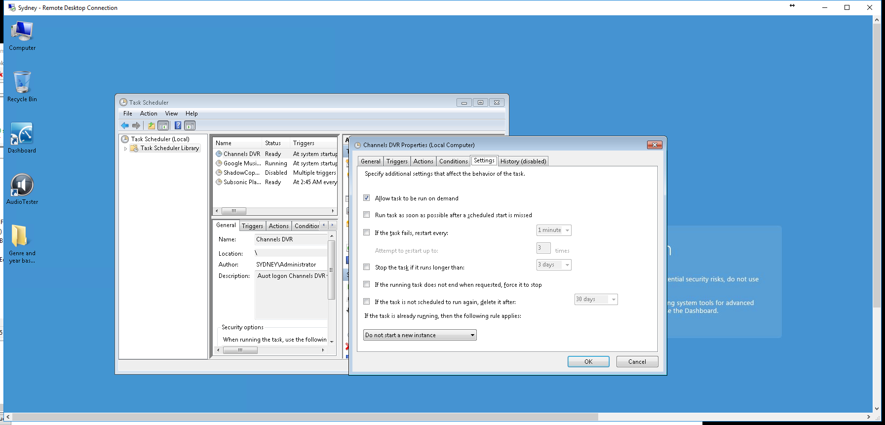

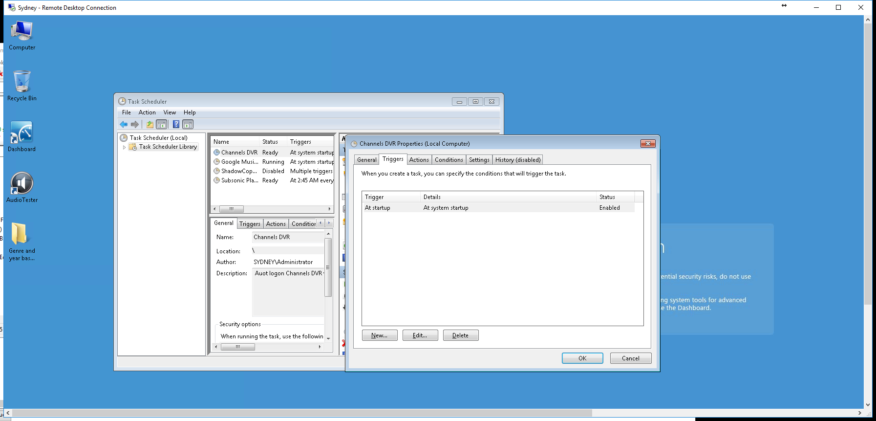

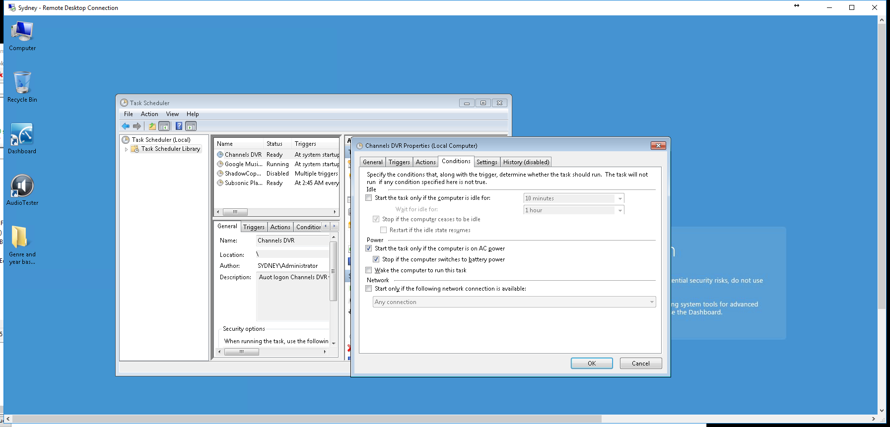

I’m trying out the Task Scheduler now, but am still unsure what settings to use. Can you share your task’s security options?
Okay I think I see what’s going on… as of the last DVR release, the channels-dvr.exe no longer runs inside Task Scheduler. It crashes on boot with this error message:
[ERR] Could not start windows app: Shell_NotifyIcon
I think what was happening in your case, whenever you login to your windows machine the Auto-Run that the installer setup kicks off, and so the DVR does start up then. But when you logout it stops, and the Task Scheduler isn’t running it at all.

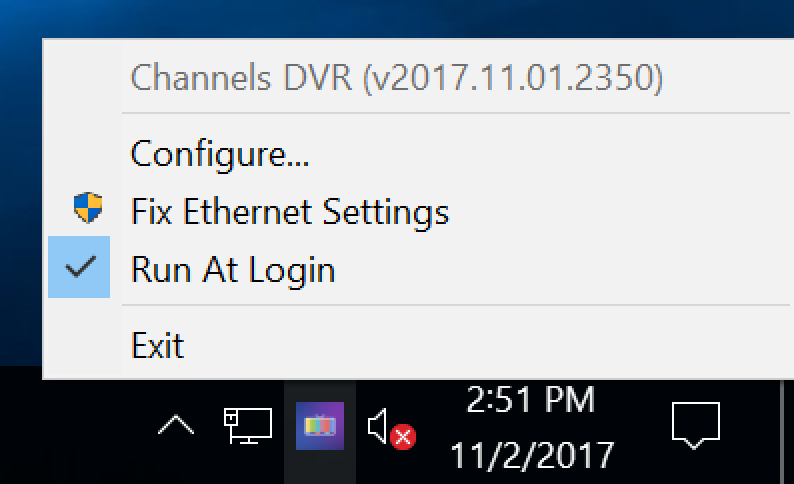

This build also has an auto-run toggle available in the system tray menu:
To switch to a Windows Service, disable auto-run and exit the DVR (or stop your Task and delete it's trigger), then run in an Administrator Powershell window:
