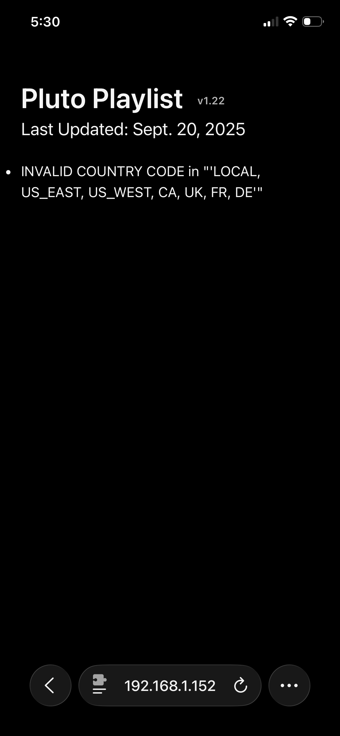

@Bobby_Vaughn trying your container out and I’m getting this error when using local. Is this expected behavior on the m3u page?

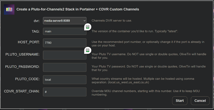

The most recent @Bobby_Vaughn image appears to be working fine via Project One-Click -- with no modifications required. I just spun it up and tested several channels:
Note that the Action is named: Pluto-for-Channels2 in Project One-Click.

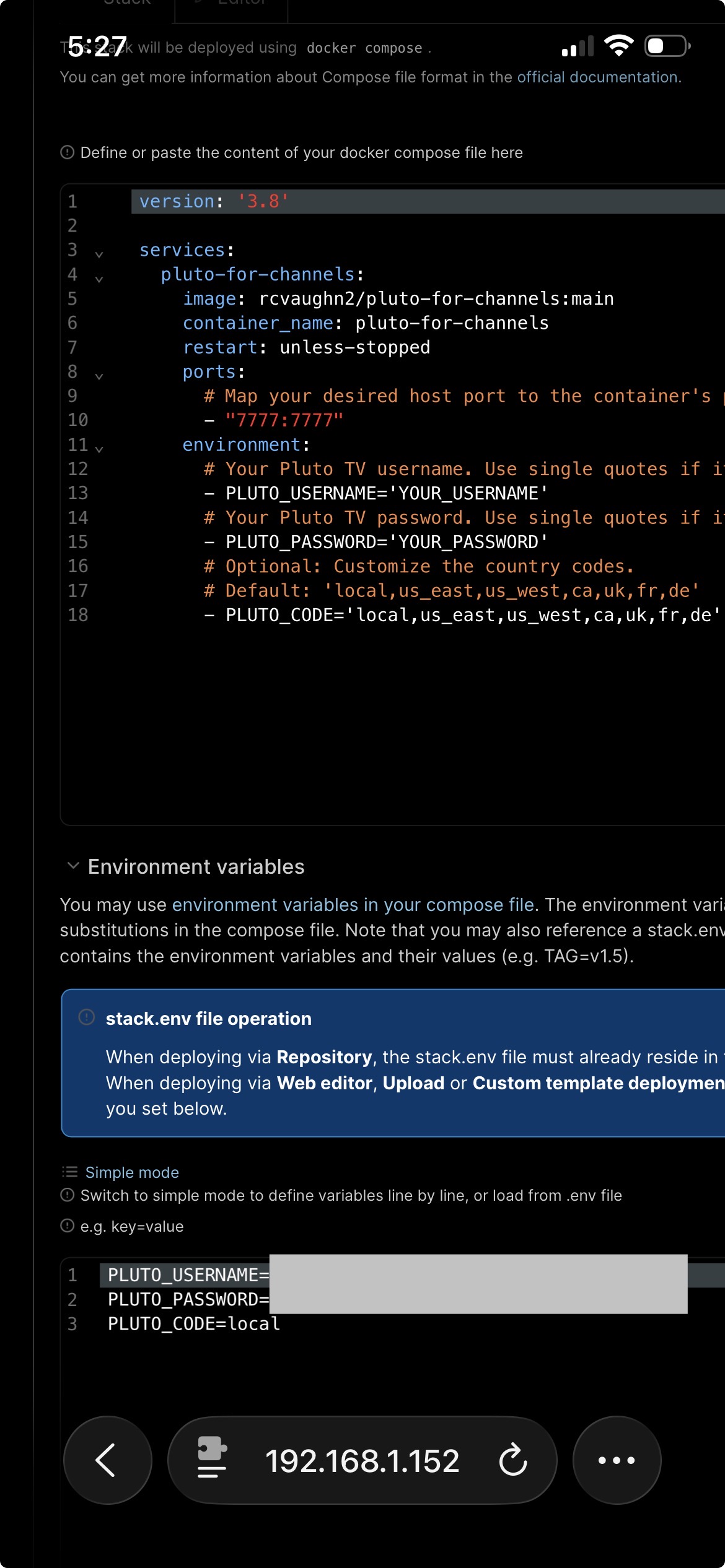

So Grok helped me get this setup in container manager /synology. It's running now successfully. Sorry if this us already posted, so how do I configure channels to now point to this container for Pluto? using port 7777:7777

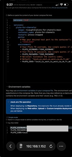

Try using the double quotes
environment:
      PLUTO_USERNAME: "YOUR_USERNAME"
      PLUTO_PASSWORD: "YOUR_PASSWORD"
      PLUTO_CODE: "local,us_east,us_west,ca,uk,fr,de"

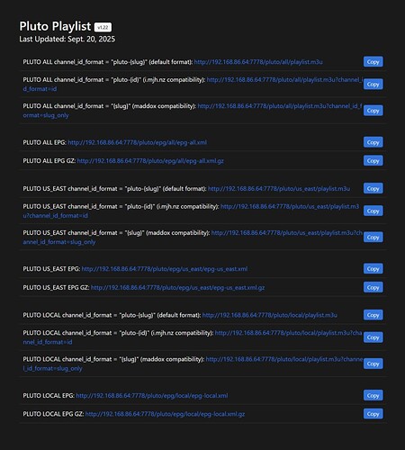

If you go to the ip address you have it installed on (192.xxx.xxx.xxx:7777) you will see the links to use for the Custom Channels in your Channels DVR source.

Got it going with docker run, I needed single qoutes.
Them special characters are tricky in docker.
