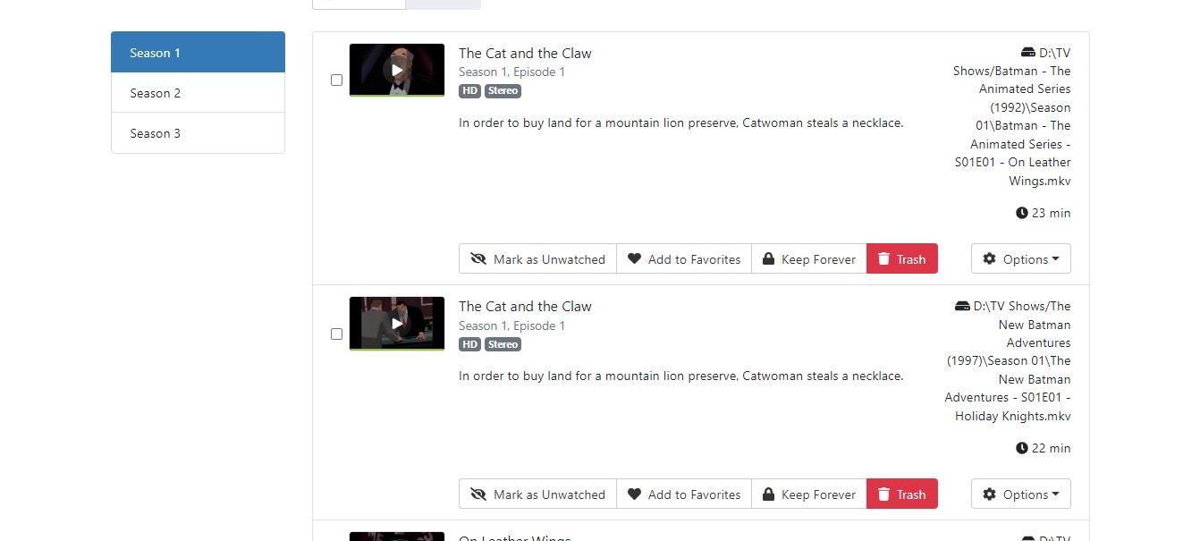

So, I realize this is a bit more of a complicated scenario but it's odd and I can't seem to sort it with "Fix Incorrect Match".
Scenario: I own "Batman: The Animated Series" and "The New Batman Adventures". In my TV Series folders I have it like this: Batman: The Animated Series (1992)/Season 01/Season 02/Season 03 with the episodes for each season in their respective season folders.
I have a separate folder for The New Batman Adventures/Season 01 and then all episodes in that one folder as that is the DVD order or absolute order. It isn't the aired order. But since I ripped it from the Bluray disc, I keep it in the order from those discs.
Both Plex and Emby read them fine.
For some reason Channels puts both these series in one listing and adds all of The New Batman Adventures episodes into the Batman: The Animated Series as Season 01 and renames each of those episodes as duplicates of each episode.
I hope that makes sense. Notice in the attached image the folder listed to the right.
If I select fix incorrect match on the episode it doesn't give me anything to select.

So if you look at "The New Batman Adventures" on Zap2It (which uses the same Gracenote data)...
... you can see that Gracenote considers this to be "Season 5", not "Season 1". Further, according to Wikipedia, the show is a "continuation of the 1990s Batman: The Animated Series", so that might be why they are getting mixed (the engine thinks it is the same show). You can even see this if you search in "Fix Incorrect Match":
Therefore, the first thing you need to do is change everything in "The New Batman Adventures" to be "S05" instead of "S01" and Purge Deleted. Next, you will want make sure you are using the correct match even for "Batman: The Animated Series". I can see in your screen shot that the episode names are not aligning and that you don't have the same number of seasons as the Zap2It data. Use Zap2It to rename and re-order all of that. By the way, you will want to take these all out of the directory Channels scans to fix first and do that purge, otherwise there will be a mass of messed up data in there. Once you have made all those corrections, then add it back in.
Finally, once all of that is done and you re-import, if they are together at least all of "New" will be in "Season 5". If you want to try and separate them after that, select all of those episodes and then try "Fix Incorrect Show":
It might be the other way around, though. Judging by the incorrect match test from above, it looks like everything got dumped into the "The New Batman Adventures" one with 5 seasons, 138 episodes.
If all else fails or is not in the order/location you want them, you can always manually edit the metadata. Good luck!

So, after manually changing everything, I am now left with Batman: The Animated Series as having 5 seasons but at least all the episodes are correctly labeled and placed. I would prefer to have the 2 shows completely separate, but I can deal with it like this.
