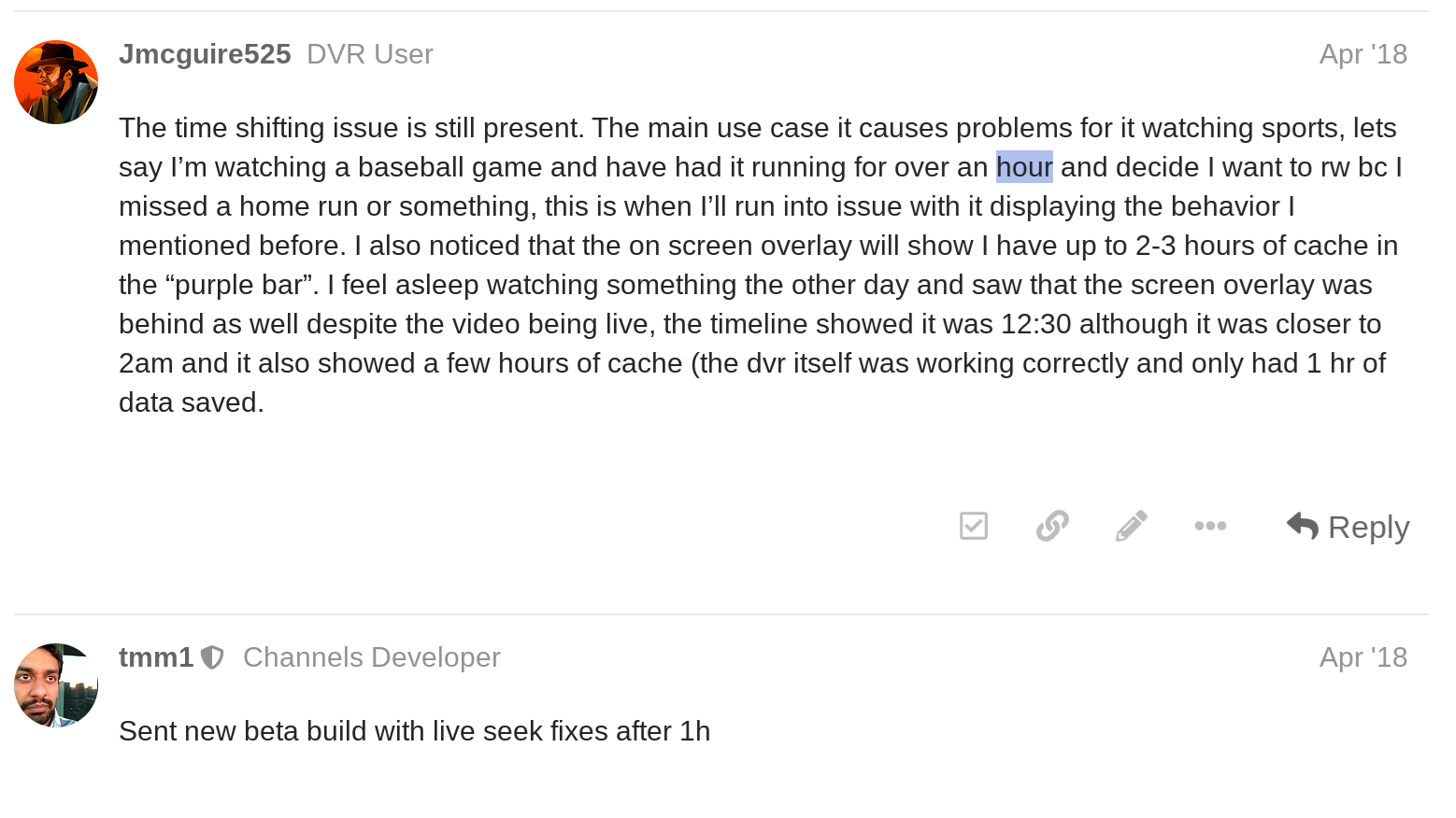

From what I remember this used to happen when watching a live show for a long period of time (sports for example). I think it had something to do with the m3u deleting old segments after an hour, but I could be wrong.

Where you able to make any progress? I can go back through my conversations with @tmm1 if you need me to bc this is pretty much the same issue we ran into a while back (or at least it seems that way).
Edit: I found this...
