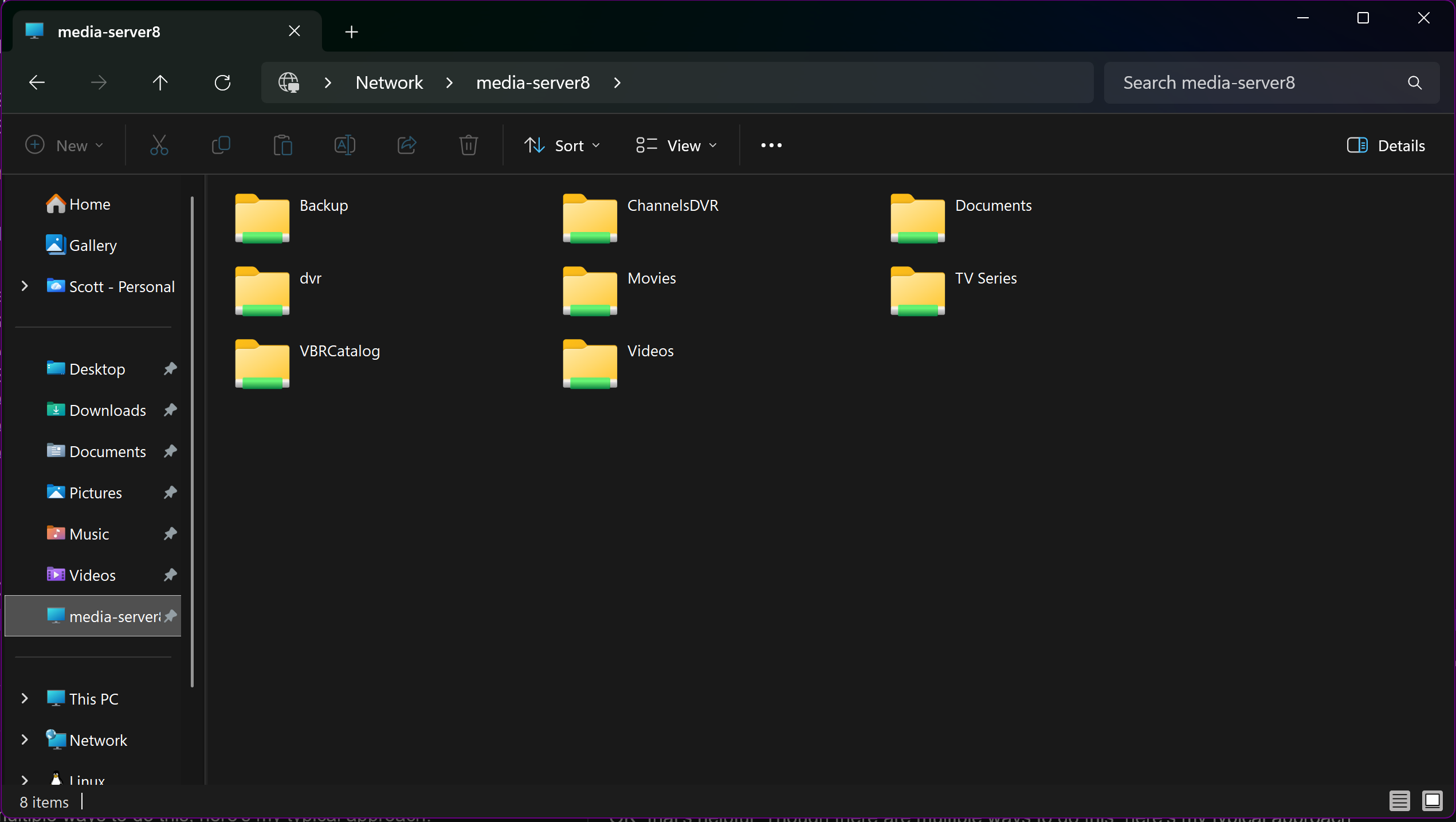

OK, that's helpful. Though there are multiple ways to do this, here's my typical approach:

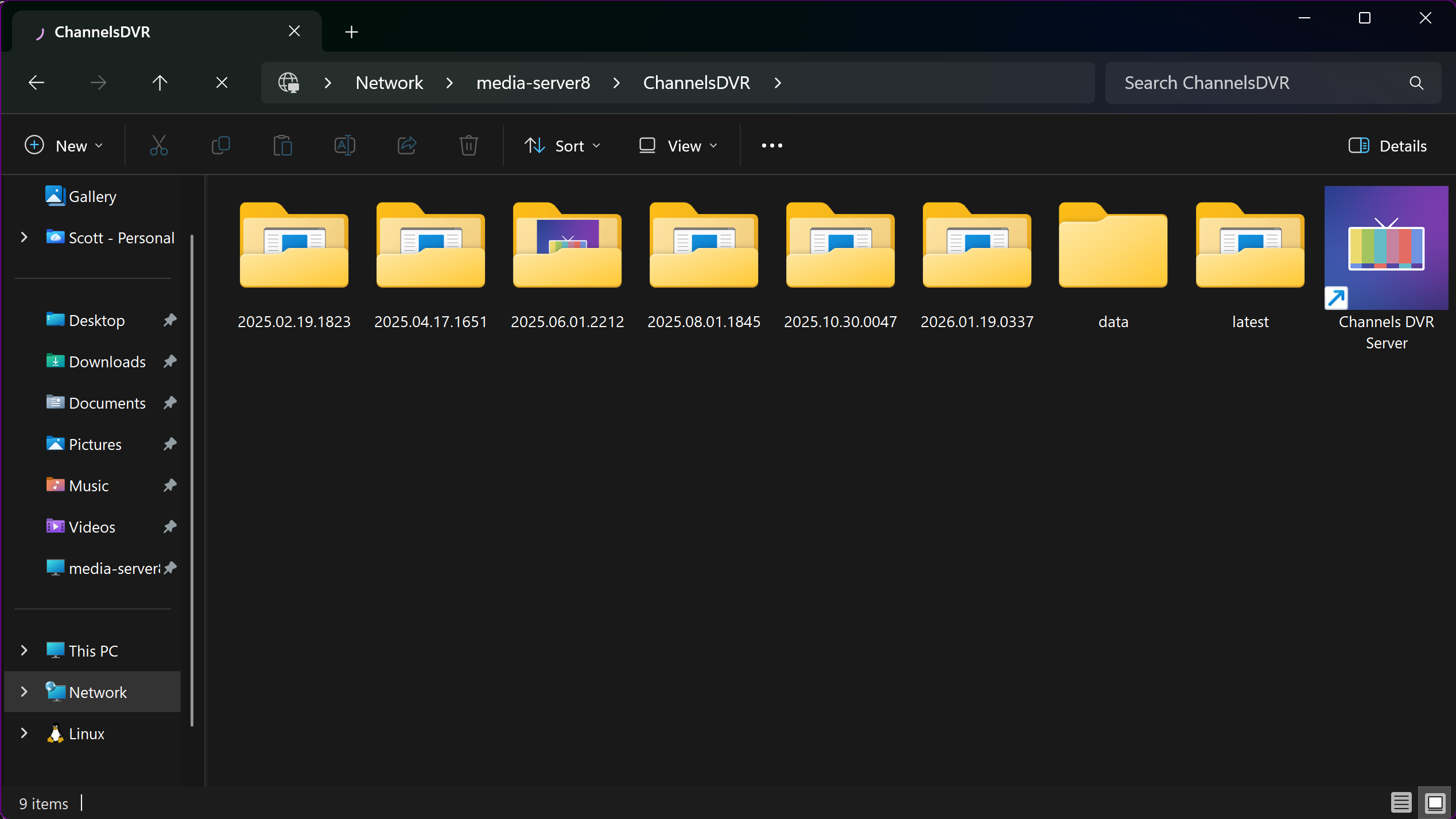

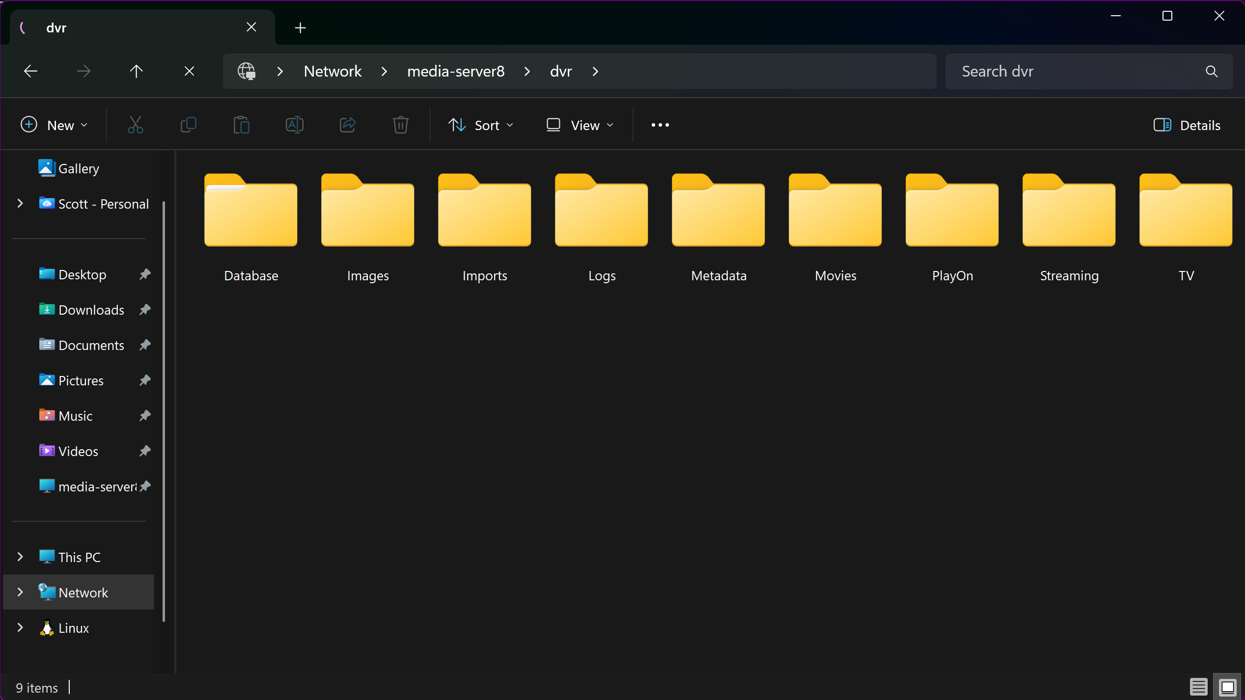

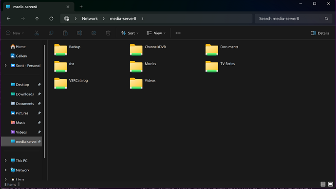

On your Windows system running CDVR, have the folder where you store DVR recordings and "Personal Media" set up as a Samba shares. Also, have the location where CDVR program files also set up as a Samba share.
Here's mine, where dvr is my CDVR recordings folder. TV Series and Movies are personal media folders, and ChannelsDVR is a Samba share of my CDVR programs (aka executables):
The dvr share contains these files:
And, the ChannelsDVR share contains:

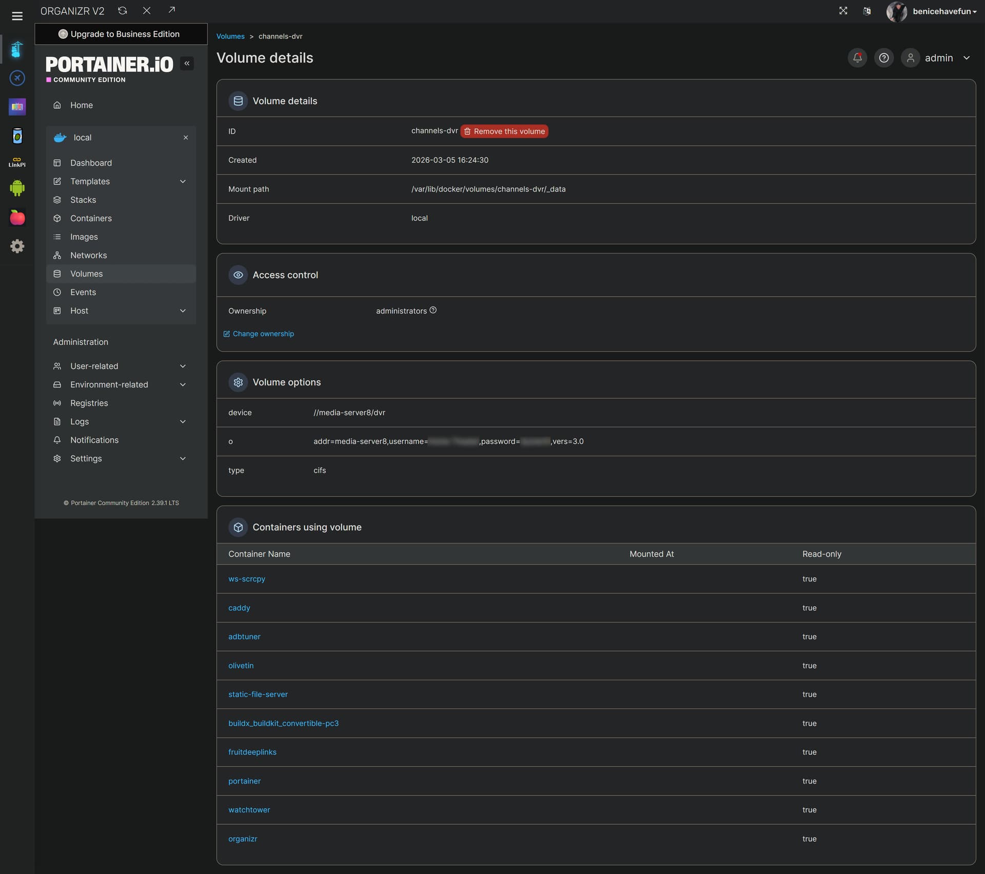

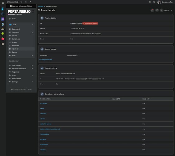

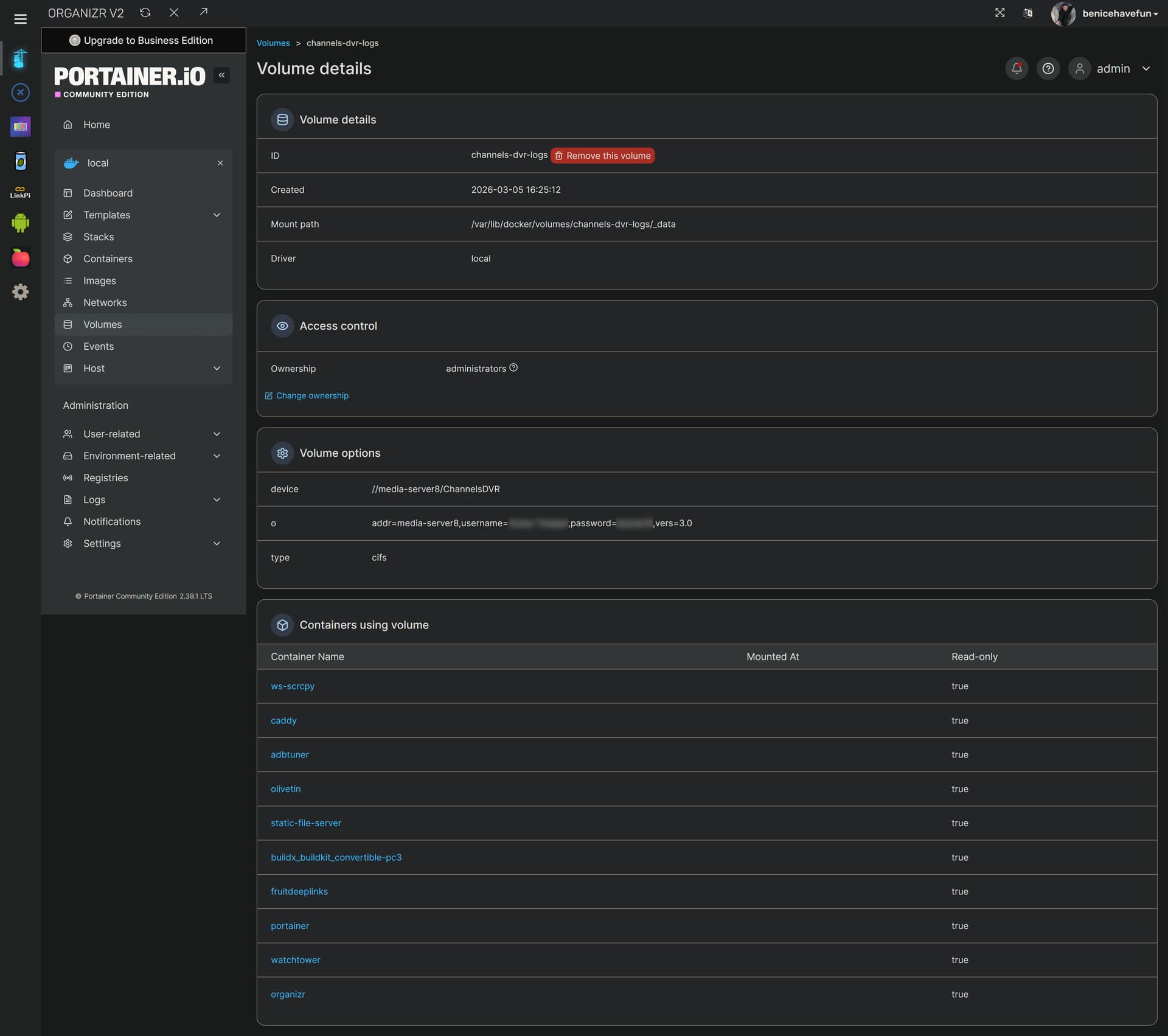

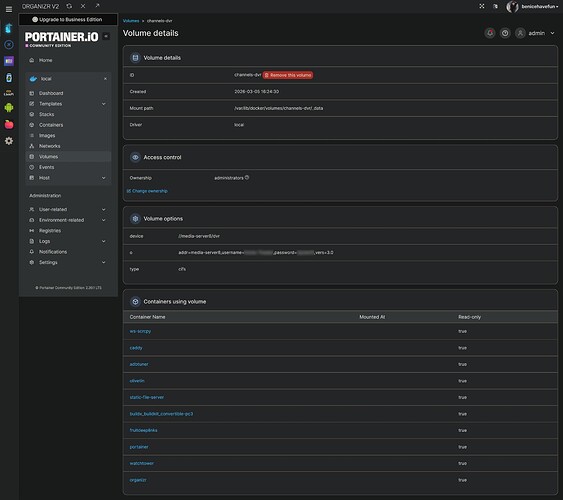

Then, in Portainer, you need to create Docker Volumes to access those shares:
A volume called channels-dvr:
And a volume called channels-dvr-logs:
The above, I would consider the "easy way" to attach Samba shares to a Docker container. It's also possible to mount Samba shares to your file system, and then use those mount points, but that's a bit more complicated.
In your OliveTin stack, you'd then uncomment the lines that include #0#, #1#, and #2#, like this:
volumes: # Remove the #x# to enable. Use this section if you've setup a docker volume named channels-dvr, with CIFS or NFS, to bind to /mnt/dvr inside the container. Set ${DVR_SHARE} to channels-dvr (DVR_SHARE=channels_dvr) in that example.
  channels-dvr:
    external: true
  channels-dvr-logs:
    external: true
  #3#tubearchivist:
    #3#external: true
  #4#channels-dvr2:
    #4#external: true
  #5#channels-dvr2-logs:
    #5#external: true
  #6#tubearchivist2:
    #6#external: true
  #7#channels-dvr3:
    #7#external: true
  #8#channels-dvr3-logs:
    #8#external: true
  #9#tubearchivist3:
    #9#external: true
Finally, you'd modify these two env vars to use these new volume names rather than paths, like so:
DVR_SHARE=channels-dvr
LOGS_SHARE=channels-dvr-logs

When you replace the Docker Compose you're using with this more up-to-date version, be sure to un-comment those same lines in the volumes section to support your Samba shares.
OK. Done. I'm getting there...slowly. Finding things on CDVR website always is a problem.
Checking your OliveTin-for-Channels installation...
(extended_check=false)
OliveTin Container Version 2026.04.23
OliveTin Docker Compose Version 2025.08.25
Checking that your selected Channels DVR server (192.168.1.62:8089) is reachable by URL:
HTTP Status: 200 indicates success...
100  1276  100  1276    0     0   504k      0 --:--:-- --:--:-- --:--:--  623k
HTTP Status: 200
Effective URL: http://192.168.1.62:8089/
Checking that your selected Channels DVR server's data files (/mnt/192.168.1.62-8089) are accessible:
Folders with the names Database, Images, Imports, Logs, Movies, Streaming and TV should be visible...
total 8
drwxr-xr-x 2 root root 4096 Mar 29 22:35 .
drwxr-xr-x 1 root root 4096 May  2 03:46 ..
drwxr-xr-x 2 root root    0 May  1 09:04 Database
drwxr-xr-x 2 root root    0 May  2 02:31 Images
drwxr-xr-x 2 root root    0 Oct 14  2023 Imports
drwxr-xr-x 2 root root    0 Apr 29 23:01 Logs
drwxr-xr-x 2 root root    0 May  2 01:00 Metadata
drwxr-xr-x 2 root root    0 Mar 29 22:35 Movies
drwxr-xr-x 2 root root    0 Mar 29 22:35 Streaming
drwxr-xr-x 2 root root    0 Apr 25 23:59 TV
Docker reports your current DVR_SHARE setting as...
/var/lib/docker/volumes/channels-dvr/_data
If the listed folders are NOT visible, AND you have your Channels DVR and Docker on the same system:
Channels reports this path as...
D:\DVR
When using WSL with a Linux distro and Docker Desktop, it's recommended to use...
/mnt/d/DVR

Docker reports your current LOGS_SHARE setting as...
/var/lib/docker/volumes/channels-dvr-logs/_data
C:\ProgramData\ChannelsDVR
/mnt/c/ProgramData/ChannelsDVR
