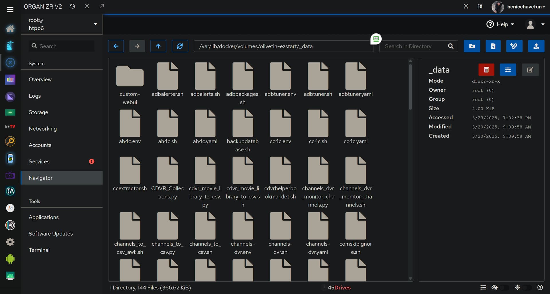

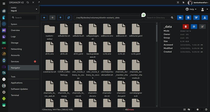

Where would this olivetin volume be and how would one access it?
Is it a docker volume or a mapped host directory?
Sorry yes, a Docker Volume. Accessing it is what makes Docker Volumes somewhat less desirable in my mind, as Docker Volumes are buried in the file system:
But, the question is, how often does the average user need to find their way there. Given that it works across OS's, without the need to create it first, is a pretty big plus.
I'm really just talking about defaulting to something that will definitely work, instead of defaulting to /data which often doesn't work.
I agree a quick and easy setup is preferable. Up to you since you support it.
Like you said, us more advanced users would avoid docker volumes.
