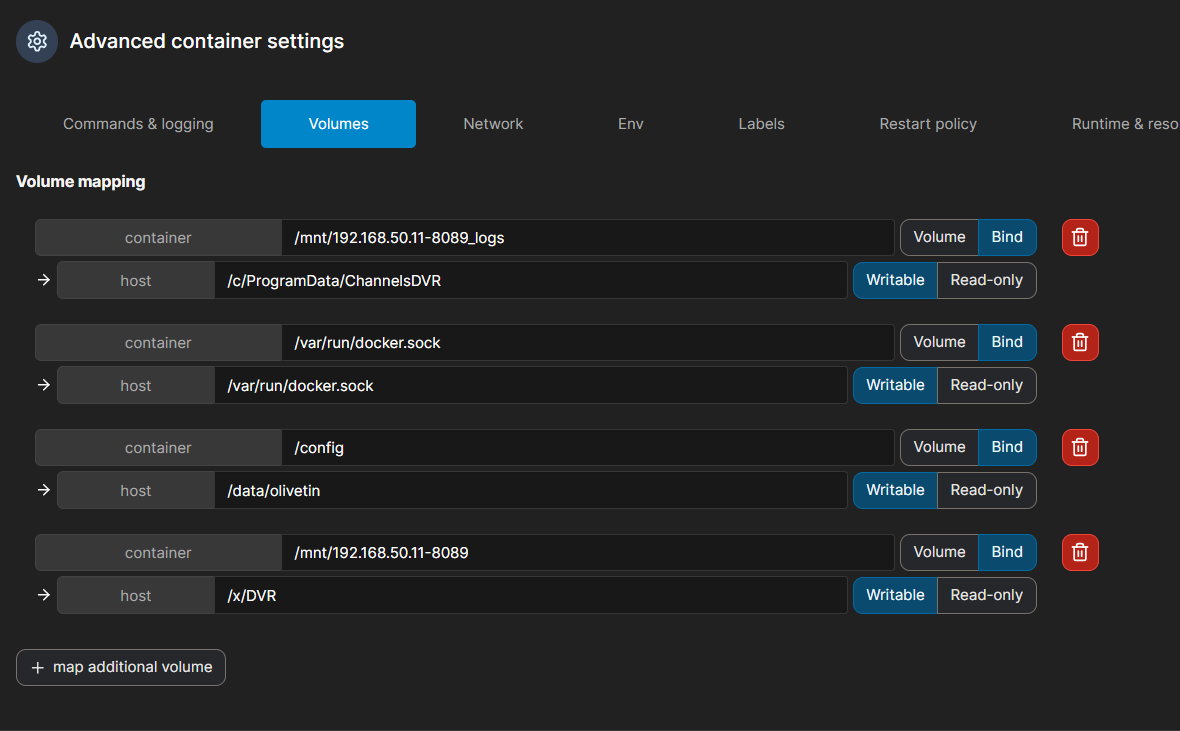

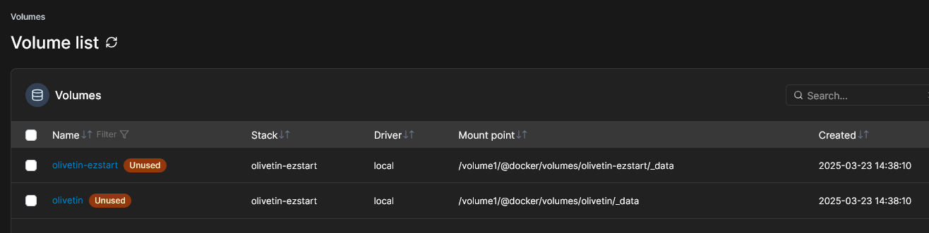

This is what it looks like after I stop and redeploy no change. I think I rather do the Variables manually lol.

The compose doesn't change. With the exception of uncommenting volume names (if needed) in the compose, all that ever changes are the env vars in that section of Portainer-Stacks.

Checking your OliveTin-for-Channels installation...
(extended_check=false)
Version 2025.03.22
Checking that your selected Channels DVR server (192.168.50.11:8089) is reachable by URL:
HTTP Status: 200 indicates success...
100  1276  100  1276    0     0  1246k      0 --:--:-- --:--:-- --:--:-- 1246k
HTTP Status: 200
Effective URL: http://192.168.50.11:8089/
Checking that your selected Channels DVR server's data files (/mnt/192.168.50.11-8089) are accessible:
Folders with the names Database, Images, Imports, Logs, Movies, Streaming and TV should be visible...
total 4
drwxrwxrwx 1 root root 4096 Mar 22 19:22 .
drwxr-xr-x 1 root root 4096 Mar 23 13:31 ..
drwxrwxrwx 1 root root 4096 Mar 23 09:02 Database
drwxrwxrwx 1 root root 4096 Mar 22 19:22 Images
drwxrwxrwx 1 root root 4096 Mar 22 19:22 Imports
drwxrwxrwx 1 root root 4096 Mar 22 19:22 Streaming
If the listed folders are NOT visible, AND you have your Channels DVR and Docker on the same system:
Channels reports this path as...
X:\DVR
When using a Windows path in Portainer, change the backslashes to slashes like this...
X:/DVR
When using WSL with a Linux distro and Docker Desktop, it's also possible to use...
/mnt/x/DVR
Checking that your selected Channels DVR server's log files (/mnt/192.168.50.11-8089_logs) are accessible:
Folders with the names data and latest should be visible...
total 8
drwxrwxrwx 1 root root 4096 Mar 23 07:25 .
drwxrwxrwx 1 root root 4096 Mar 17 08:45 2025.03.17.1435
drwxrwxrwx 1 root root 4096 Mar 18 18:11 2025.03.19.0001
drwxrwxrwx 1 root root 4096 Mar 18 20:51 2025.03.19.0243
drwxrwxrwx 1 root root 4096 Mar 19 18:41 2025.03.20.0031
drwxrwxrwx 1 root root 4096 Mar 20 15:26 2025.03.20.2117
drwxrwxrwx 1 root root 4096 Mar 21 19:36 2025.03.22.0129
-rwxrwxrwx 1 root root  829 Mar 23 07:25 Channels DVR Server.lnk
drwxrwxrwx 1 root root 4096 Mar 23 13:05 data
drwxrwxrwx 1 root root 4096 Mar 23 07:25 latest
C:\ProgramData\ChannelsDVR
C:/ProgramData/ChannelsDVR
/mnt/c/ProgramData/ChannelsDVR
Checking if your Portainer token is working on ports 9000 and/or 9443:
Portainer http response on port 9000 reports version
Portainer Environment ID for local is
Portainer https response on port 9443 reports version

Be aware the current Windows style paths you're using won't work with newer versions of Docker. At some point you'll need to switch to /F/ instead of F:/ and /C/ instead of C:/. I believe those drive letters can be either upper or lower case.
One of the discoveries working with @Edwin_Perez today... :slight_smile:
Thought this would be quick and easy, but no, it's Synology.
Removed and deleted my current OliveTin for Channels Portainer Stack.
Deleted the images.
Deleted my host directories for OT4C and SFS.
Spun up a Channels DVR Server container.
Deploying the EZ-Start, not so EZ.
2025-03-23 14:24:01 Deployment error: Failed to deploy a stack: compose up operation failed: Error response from daemon: driver failed programming external connectivity on endpoint static-file-server-ezstart (47b78c35e9304b9277ee05ef9def9d01b781fc9e4d89e1fd0a2aeceeb2dbad15): Bind for 0.0.0.0:8080 failed: port is already allocated.
 Fixed by adding env var HOST_SFS_PORT=8088
2025-03-23 14:29:26 Deployment error: Failed to deploy a stack: compose up operation failed: Error response from daemon: Bind mount failed: '/olivetin/data' does not exists
 Fixed by adding env var HOST_DIR=/volume1/docker and created Host directory /volume1/docker/olivetin/data
2025-03-23 14:38:14 Deployment error: Failed to deploy a stack: compose up operation failed: Error response from daemon: Bind mount failed: '/volume1/docker-ezstart' does not exists.
 Issue is Compose volumes: - ${HOST_DIR:-olivetin}${EZ_START:-/olivetin}:/config # Add the parent directory on your Docker you'd like to use.
That's where I stopped. I don't want to modify anything in the compose.
Makes sense, and I'll make a change here as static-file-server isn't important to the process, so I'll see what I can do to prevent that from being an issue.
This is more puzzling, as one of the EZ-Start concepts is to not use a directory binding at all, but rather use a Docker Volume. Does Synology require Docker Volumes to be created in advance too, like it does with directory bindings?
Basically the same issue here regarding Docker Volumes.
@chDVRuser Based on some quick research it appears this is the case. However, I may be able to use something called an Anonymous Volume. Which, are not persistent, but that's totally fine for this purpose. I'll check into it further...
Synology Docker does create Container directories.
Synology Docker does NOT create Host directories.
What is this used for?
volumes: # use this section if you've setup a docker volume named channels-dvr, with CIFS or NFS, to bind to /mnt/dvr inside the container. Set ${DVR_SHARE} to channels-dvr (DVR_SHARE=channels_dvr) in that example.
  olivetin-ezstart:
  olivetin:
I noticed these two docker volumes were created
I don't use Docker Volumes.
Everything I do is with Host directory bindings.
