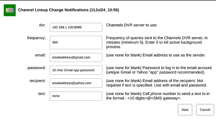

When I set up Olivetin, I identified "Alert" email variable such as SMTP server, "from" address, password, and "to" address.
When enabling the Channel Lineup Change Notifications action, do I need to put these variables in again in order to receive email notification of lineup changes? If so, there is no prompt SMTP server. Do I also need to generate a new "app password" for my "from" email account. Or can I use the same one I initially created for Olivetin?
I think that I may be entering something incorrectly. When I try to enable the Lineup Notifications with my email account information, Olivetin gets stuck on "waiting for result".
You do. This Action was created before I added e-mail notifications to OliveTin itself. At some point I'll probably circle back and incorporate the OliveTin values, but for the time being it's seperate.
I believe the SMTP server is assumed based on the "from" email address, but in any case, it's not a needed argument.
You can use the same values.
Make sure your entries look like this, with the email and recipient values included, along with your app password:
If you have an idea how you may have done it differently before, let me know, as I'd like to add error handling to cover it.
This is the format of the entries I used when the action would not complete:
