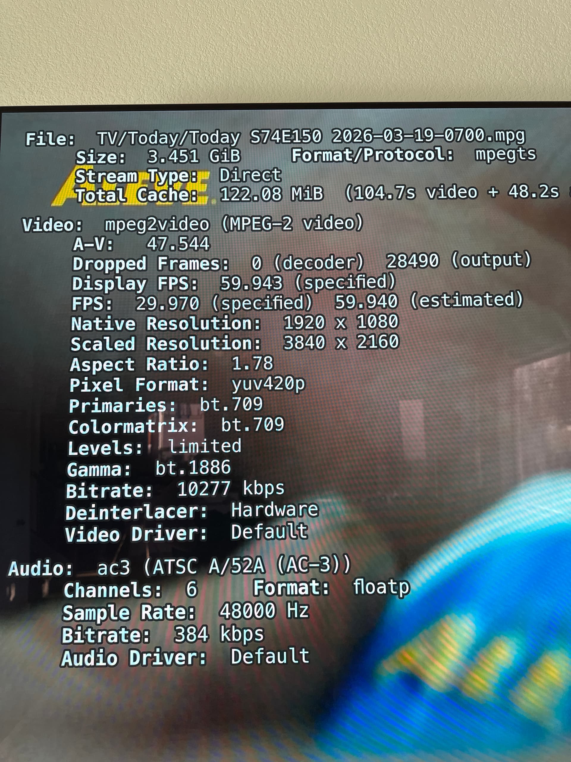

OTA dropping massive amount of frames. Started happening several weeks ago (during Olympics is when I first noticed). Consistently happens on any OTA station if I leave it playing for an hour or so. In this screenshot, I was recording a live event, watching it maybe half hour behind live, and it started dropping frames to the point where audio and video were out of sync by 30 seconds or more. The recording seems to be fine (I can scrub back and it starts playing back great again).
Logs submitted: a4e922ee-4187-4aca-b8bc-2eec165089ea
