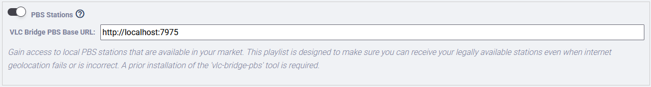

Open m3u for the PLM Internal Playlist in a text editor, should look something like this:
Note the highlighted part. This is equal to what you put here:
Did you use https instead of http? Did you put more than this? Does SLM have access to the location where the VLC Bridge PBS is set up?
THANK YOU....
So I'm looking at part of the line:
http://10.0.0.10:8178//pbs/watch/838f7279-cacf-4561-bd33-ac9a4b1429e8/ga-main
notice the // after the port?
So I went back to your second screenshot and I noticed that I did indeed have the trailing / and so I removed it and saved...
It's working now...
Thank you again.

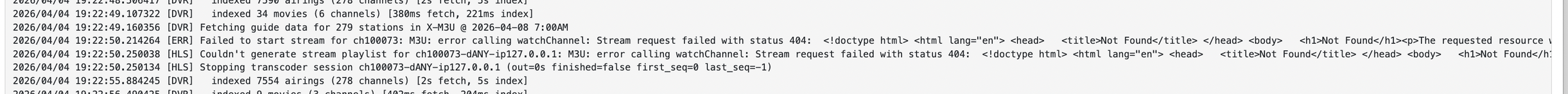

Thanks for chiming in, Waffles. I checked all mentioned above (correct file format, VLC bridge and SLM urls match). The internal playlist url matches what's being generated in the text editor. I deleted and added a handful of times, streams and epgs populate, but will not play on VLC or in Channels DVR.
I am not using VPN/tailscale.
CDVR logs says:
the one thing I'm not sure how to check: "does SLM have access to the location where VLC Bridge PBS is set up?" I assume my SLM has access because everything is on the same machine (SLM, VLC bridge, and CDVR are on the same intel macbook pro)
I am not well versed on any of this and I'm at the mercy of my ability to follow directions. This issue has me stumped and it's a bit frustrating. I watch a lot of PBS and look forward to adding sub channels to my lineup. thanks for the help

@Waffles @babsonnexus . ugh. I hesitated to post my issues here because I was fairly sure I missed something simple. Thanks to your suggestions Waffles, I looked more closely at the Docker container. I thought re-running the VLC-bridge script would update it to the latest. When I looked at the image for the container, I noticed an update of 8 months ago. Deleted the container and image, reran the script, now I'm on the latest release and everything works. thank you!
