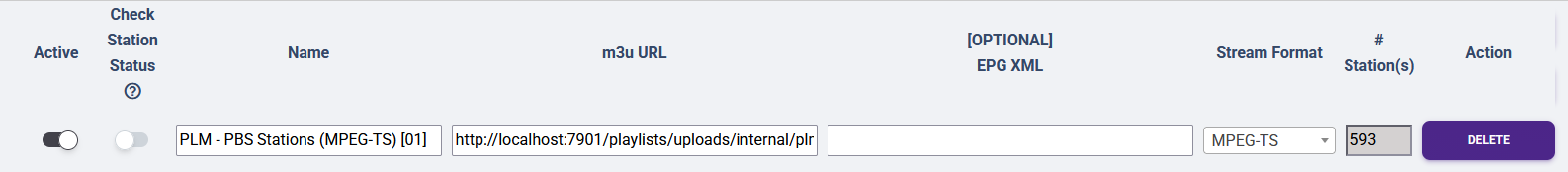

@babsonnexus thanks for all your amazing work on this. I was able to get 151 PBS feeds up and running using vlc-bridge and SLM. I'm only seeing primary feeds though, no sub-stations. Am I doing something wrong? Is there anything I need to do differently to find the sub-stations? Thanks!
Please make sure you are completely up to date on your versions of VLC Bridge PBS (last update 3 weeks ago) and SLM (last update a few days ago). I'm at 593 as of this morning:
I'm not sure what I'm doing wrong. I've updated vlc-bridge and SLM. The PBS playlist generates (593 channels). I assign local channels and sub-channels, playlist exports to my channels dvr server but I'm still not able to play/view any of the streams.
Does the base generated playlist play in anything else like VLC? Did you set the Stream Format to MPEG-TS? Are there any errors in your Channels DVR log? Are you using a VPN/Tailscale that might make you out of the country? Everything works here, so going to need a lot more info to assist.
