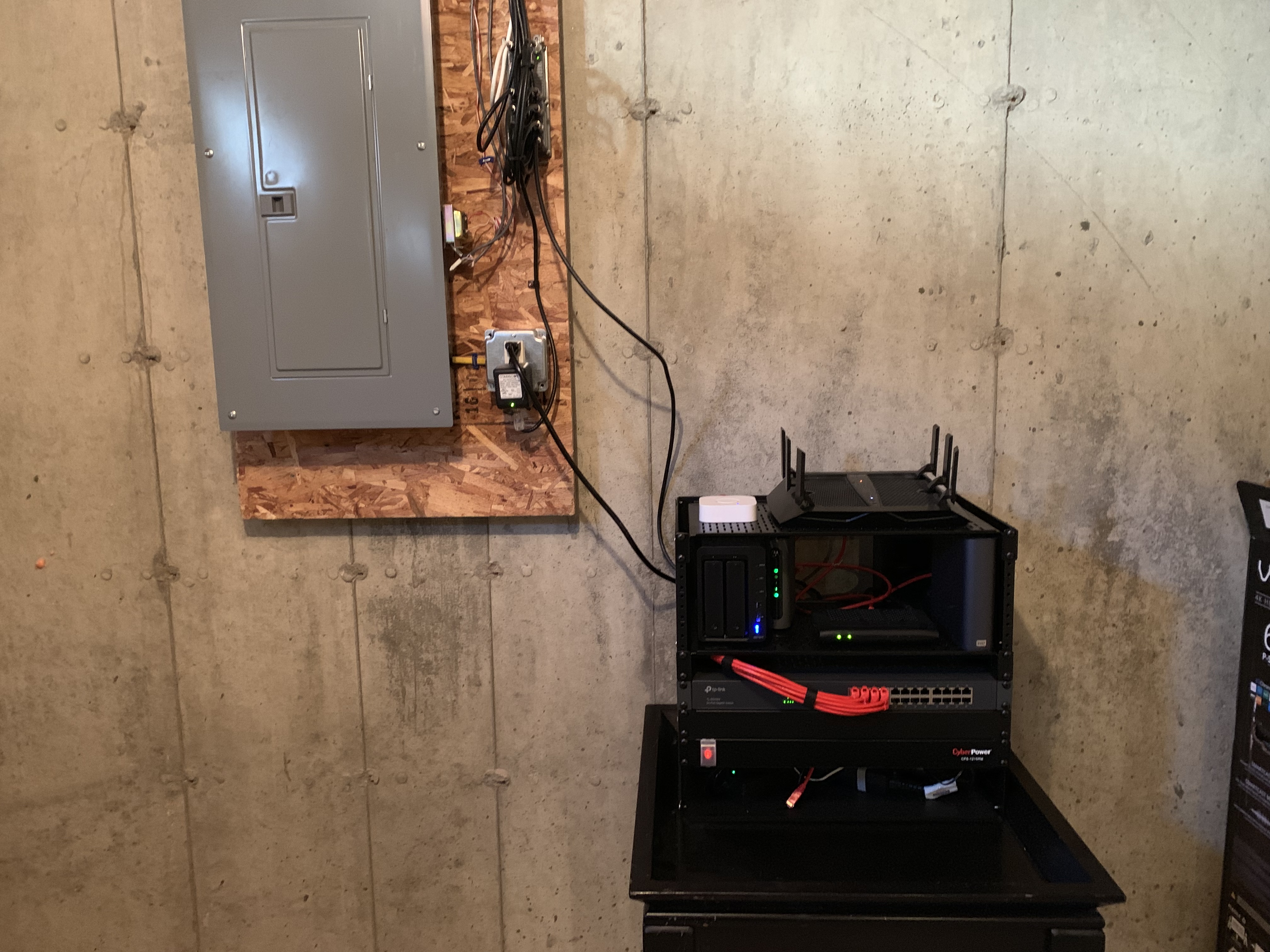

Well, sounds like I’ll be saving some money and investing in Ethernet cords versus SSD. Now I just need to figure out how to get it over to the living room. That or a good mesh network... Ethernet is probably a lot cheaper but without a doubt higher performance. Picture of my basement server, just because, basement isn’t helping. image
I'd think you'd be well-positioned to drill up from the basement to the inside of an interior wall, where you can cut a hole and install a junction box. Or, if you're squeamish about cutting into a wall, install a surface mount Ethernet port (eg. https://www.lowes.com/pd/rca-cat-6-ethernet-white-data-cable-box/3701476) on the baseboard.
Running Ethernet Cable is best if you can. However, if that is a problem and you have COAX run to your basement and other places in the house you should could consider MOCA. I use this in a couple of hard to reach places. You just need 1 at the router and you can place others in multiple locations.
But you have a full basement. And probably walls are drywall? You can do it.
Or like @VTTom suggested, just run the cables outside the walls (could use wiremold) and mount the jack on the surface of the wall.
I asked this question, went on vacation, and forgot to check back. This sealed it for me, going to try to run some ethernet to the ATV and if I can't due that I'll upgrade to a mesh network or maybe even MoCA.
Depending on the brand, mesh might introduce more problems because of additional bandwidth needed for all stations to talk to each other. You're better off skipping mesh and going to MoCA. Or, if wireless is still the way you want to play it, use separate access points connected by Ethernet to a switch, not wholly wireless.
