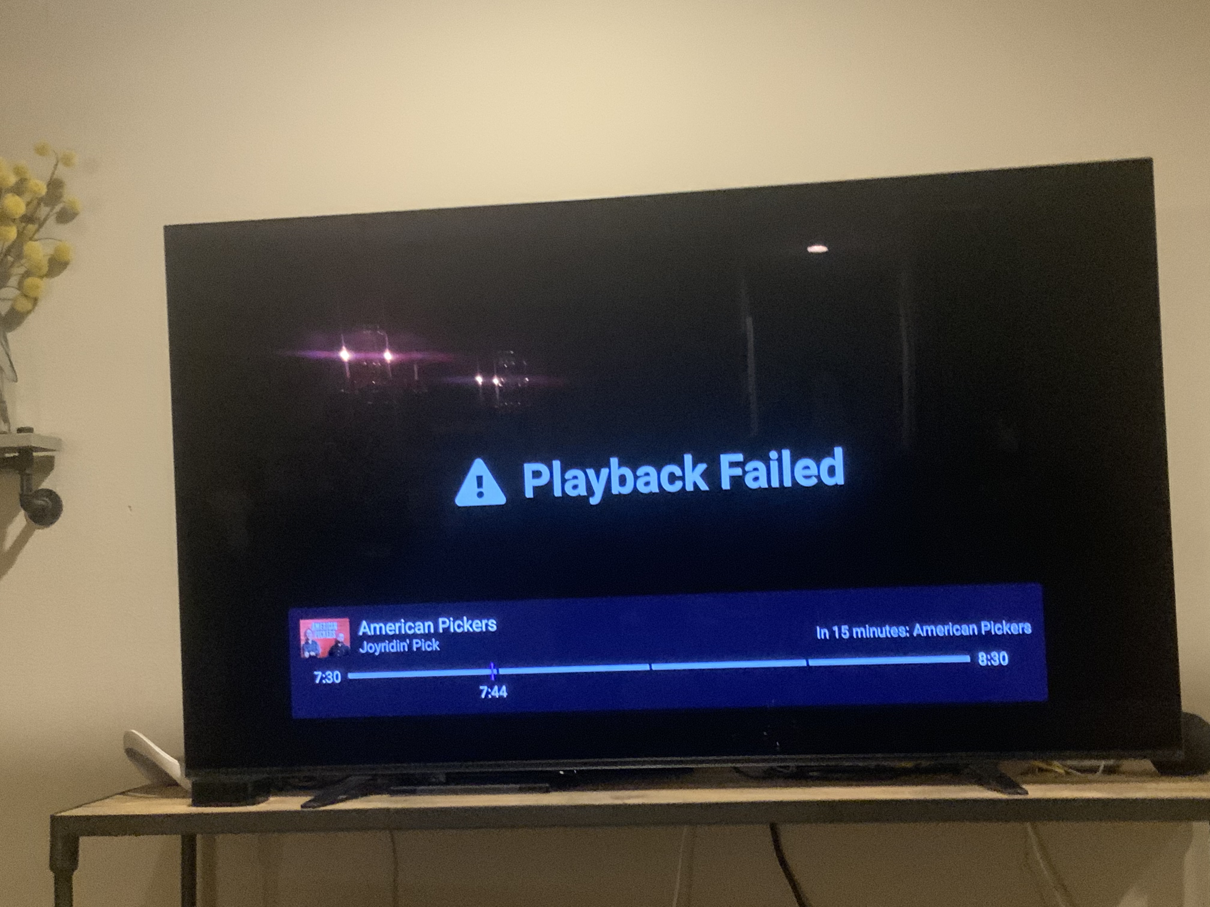

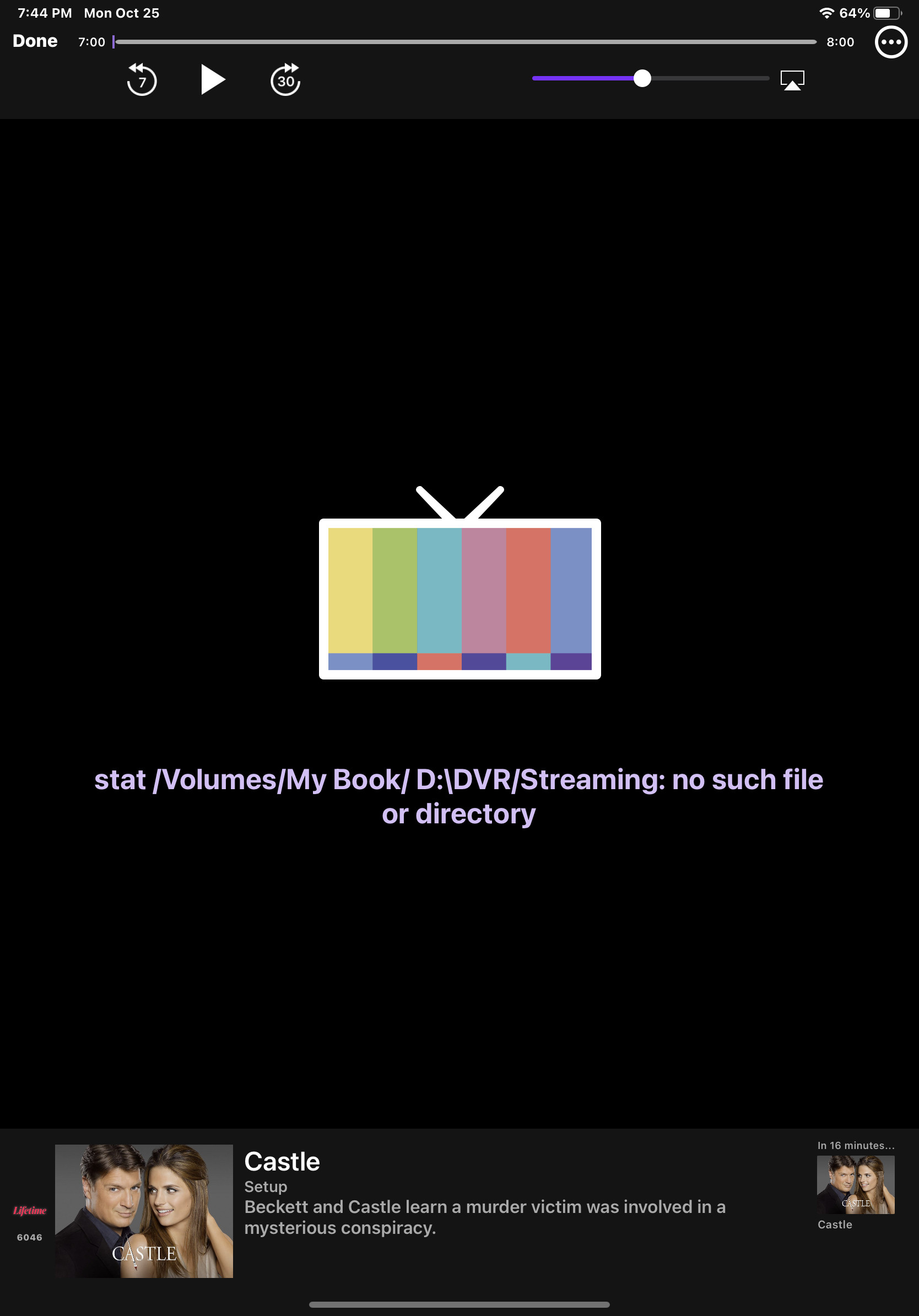

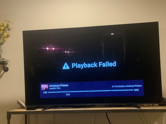

Hi I am trying to get philo to work. I updated channels on my computer and the app and still not working. I keep getting playback failed and the other one below on my ipad. Please help as I am kinda new and not sure what to do..thank you for help :pray:
Your DVR is not configured correctly it seems. Or the USB drive has become detached.

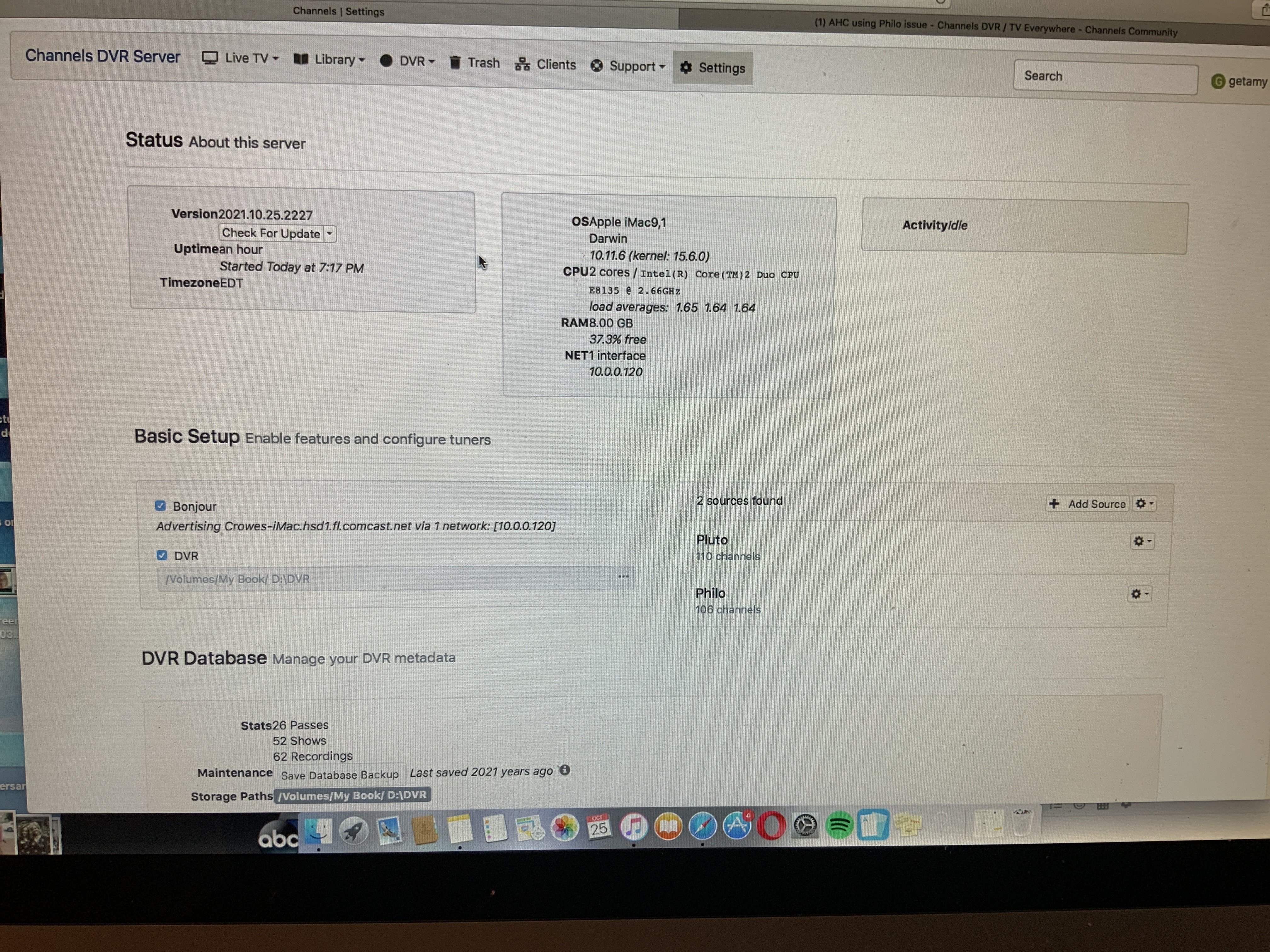

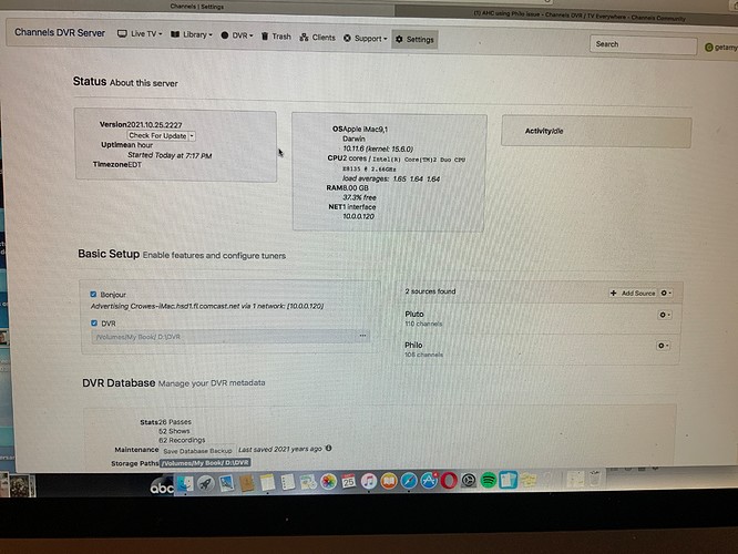

Hi thank you for response…Can I show you a picture and you can tell me if it is correct? What should I take a picture of? Does this tell you.?
hi i responed but realize i did not hit reply. Please see above. thank you against much for help

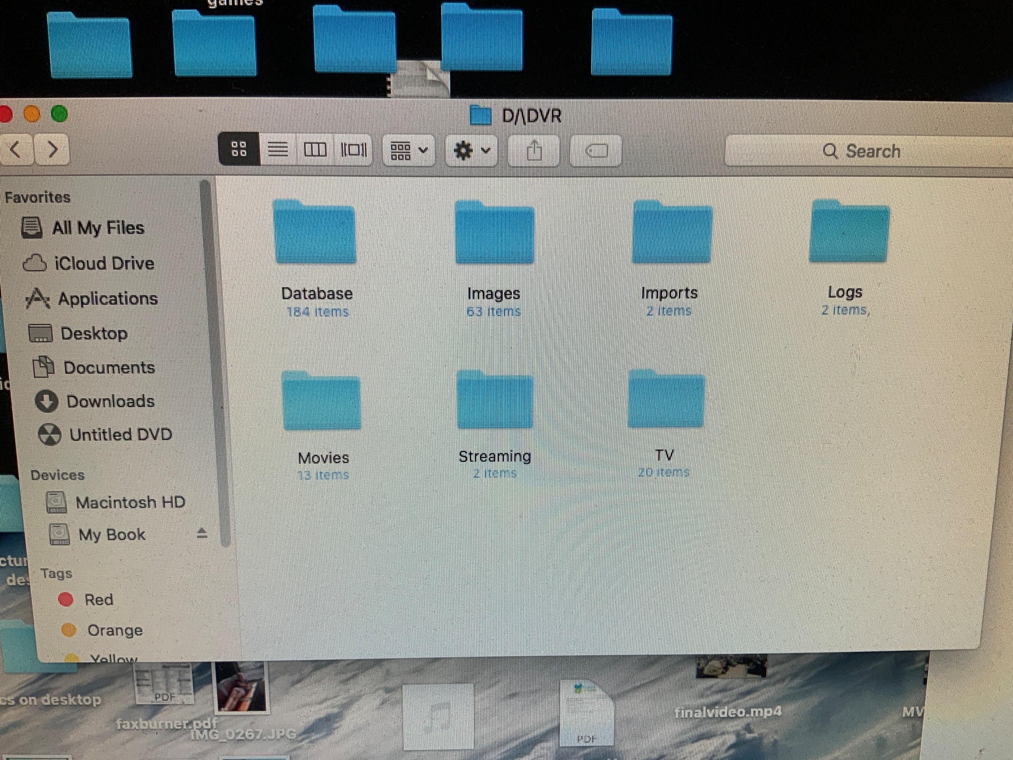

If you open Finder and go to /Volumes what does it show? Is My Book there? And what's inside My Book in Finder?
This is there …
Okay great, thanks.
What I would suggest is this:
  1. in finder, inside My Book, right click on "D/\DVR" and select rename, and change it just to "DVR"
  2. in the web UI, uncheck the dvr checkbox, then underneath change it to "/Volumes/My Book/DVR" and recheck the checkbox

ok then it already was that? Still do other steps?
Sorry never mind a misread your steps.. will do now thanks
Ok you are awesome!!! Thank you so much, it is working now. I really appreciate it. now if I could only figure out how to get local channels. I miss Locust. Would you happen to know which HomeDVR i should get? Is siliconeDust ok? Again thank you for all your help!!!

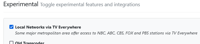

Since you already have Channels DVR setup for TVE through Philo, have you tried enabling this on the DVR web UI settings?

This would enable local channels through tve if they are available to you. Definitely try enabling and rescan tve. You may not need a tuner and antenna
