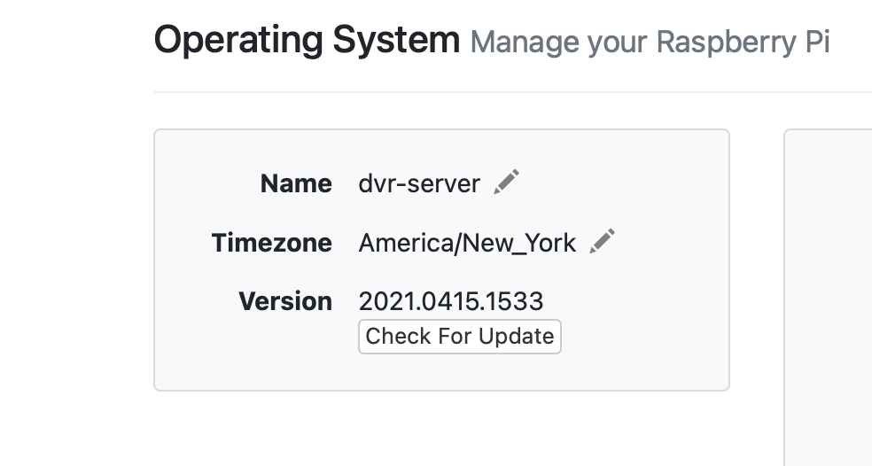

Now the time is wonky. Even though I've set the time zone
all of the log entries are in the wrong time, and some of my custom channels don't work (maybe because of the timecode?)
