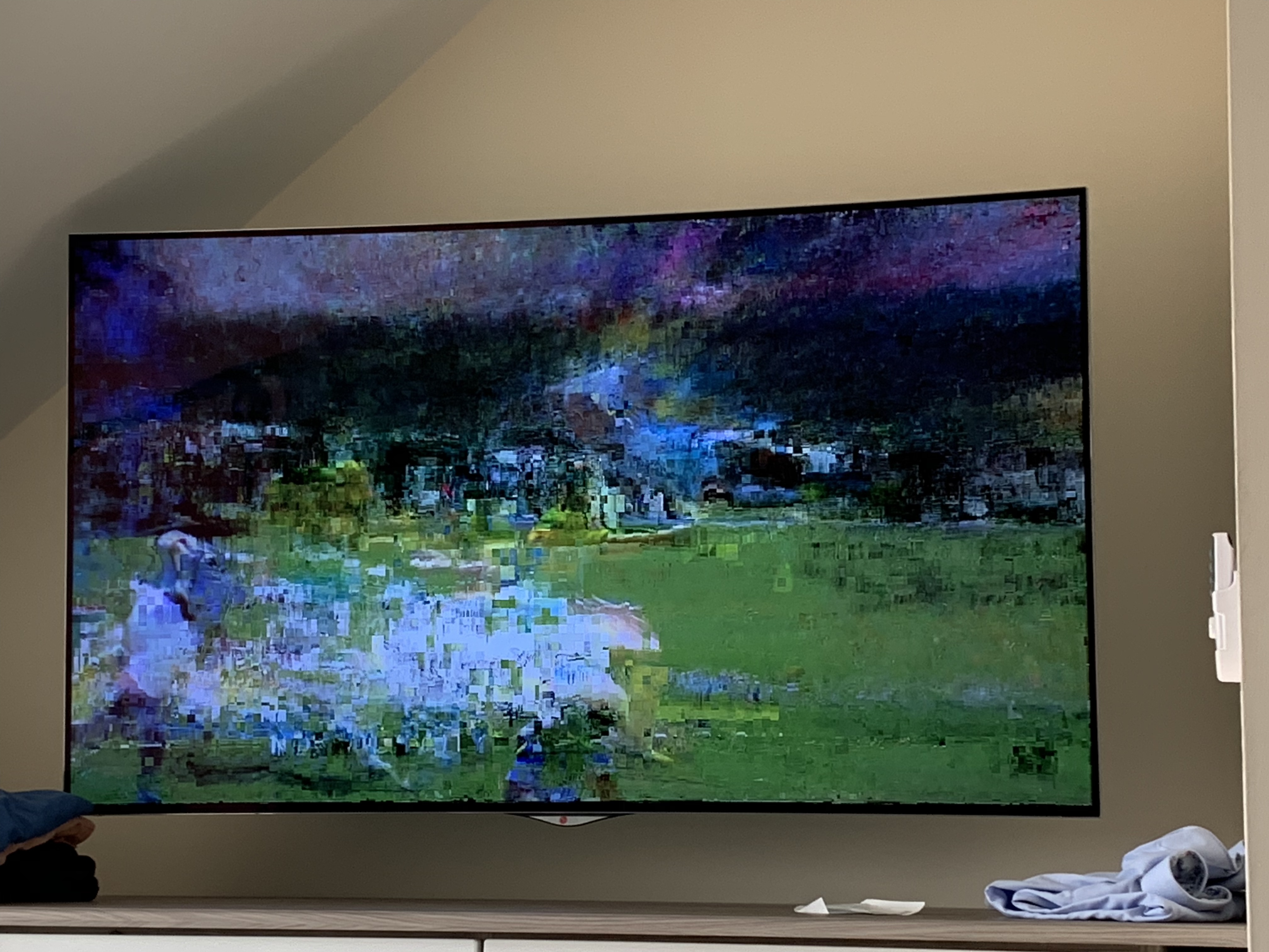

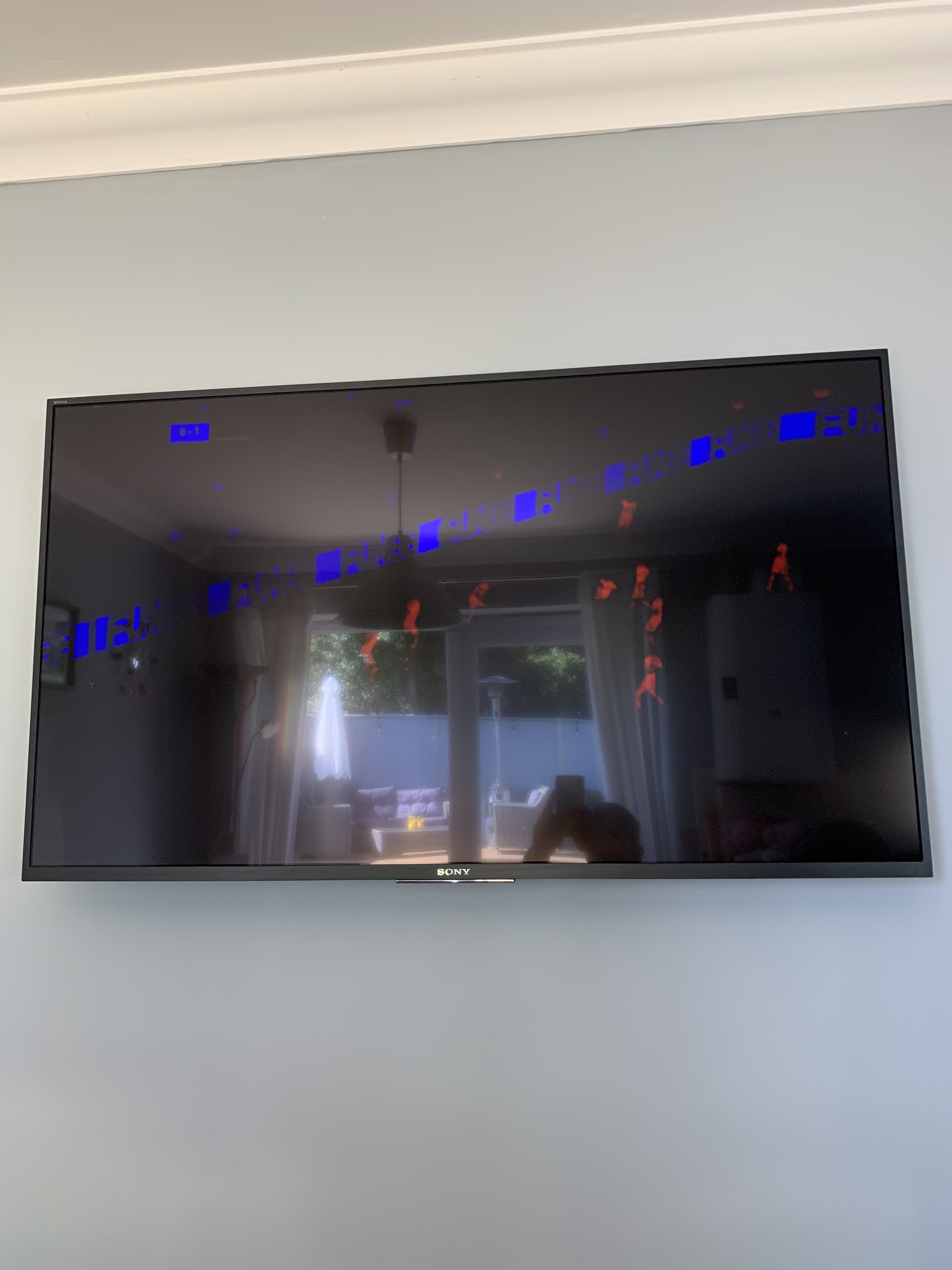

This keeps happening playing back recordings on my fire stick 4K.
Tried hardware and software rendering.
Plays fine on my shield which is the DVR.

doesnt happen with every recording, but happens with some recordings on both firesticks. For example. Match of the Day which is on BBC 1 does this (this is the show in the picture - Does this every week so not just a one off recording)
Goes dark on 2 Firestick 4Ks and stutters.
No issues viewing on Shield or iPhone
Now submitting another error log as the pictures breaking up loads.
Still getting issues... mainly BBC1HD and ITVHD Recordings. Plenty of errors logs sent in.
