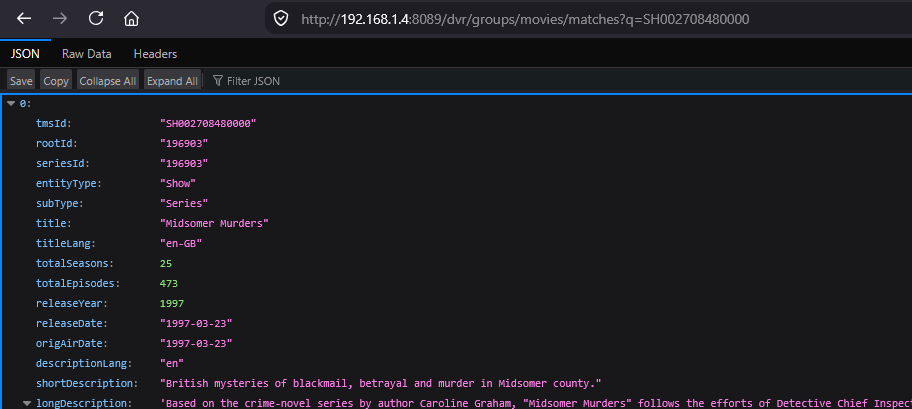

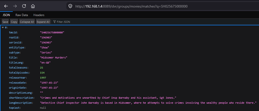

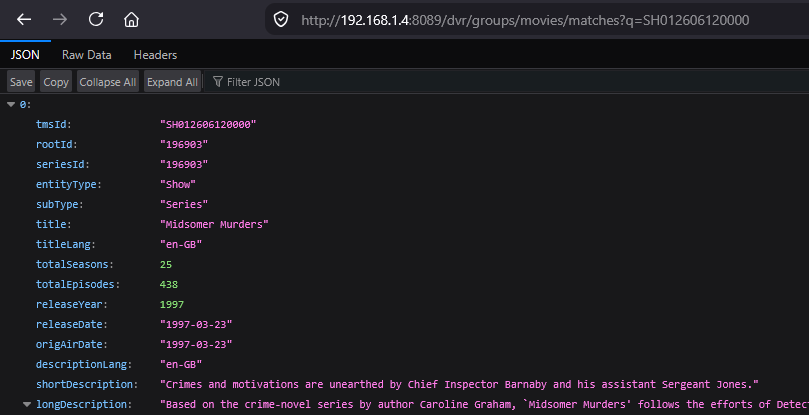

Figured out a way using what Fix Match does to retrieve by searching for the full tms ID
Example, to find the tms ID SH0256750, add 4 zeros to the end and search.
http://192.168.1.4:8089/dvr/groups/movies/matches?q=SH025675000000
It will return the Series ID as seriesId
http://192.168.1.4:8089/dvr/groups/movies/matches?q=SH002708480000
http://192.168.1.4:8089/dvr/groups/movies/matches?q=SH012606120000
Thank you!
That was exactly the solution I was looking for.

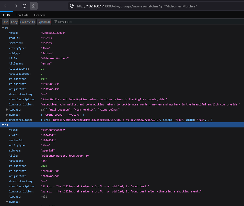

Yes, just replace the tms ID with the Title in double quotes.
This replicates what Find Match for Imports does behind the scenes.
You will get more than 1 result this way and will have to pick the correct one.
http://192.168.1.4:8089/dvr/groups/movies/matches?q="Midsomer Murders"
The double quotes don't quite work as expected, as they will also match to just the first word.
However, what does seem to work if searching for a string with blanks is to enclose it with URL encoded quotes %22 and a + between words. E.g.
http://192.168.1.99:8089/dvr/groups/movies/matches?q= %22Midsomer+Murders%22
(The space after the q is wrong but I couldn't figure out how to escape the percent code so that it wouldn't transform into quotations marks)
(still can have multiple matches, but not as many :slight_smile: )

Using the double quotes will find the phrase enclosed within them.
Try URL encoding it like this
http://192.168.1.4:8089/dvr/groups/movies/matches?q=%22Midsomer%20Murders%22
where " is %22 and space is %20
Otherwise (without the double quotes enclosing the phrase) it will search the words by ORing them.
Midsomer OR Murders
http://192.168.1.4:8089/dvr/groups/movies/matches?q=Midsomer%20Murders
http://192.168.1.99:8089/dvr/groups/movies/matches?q=%22Midsomer+Murders%22
