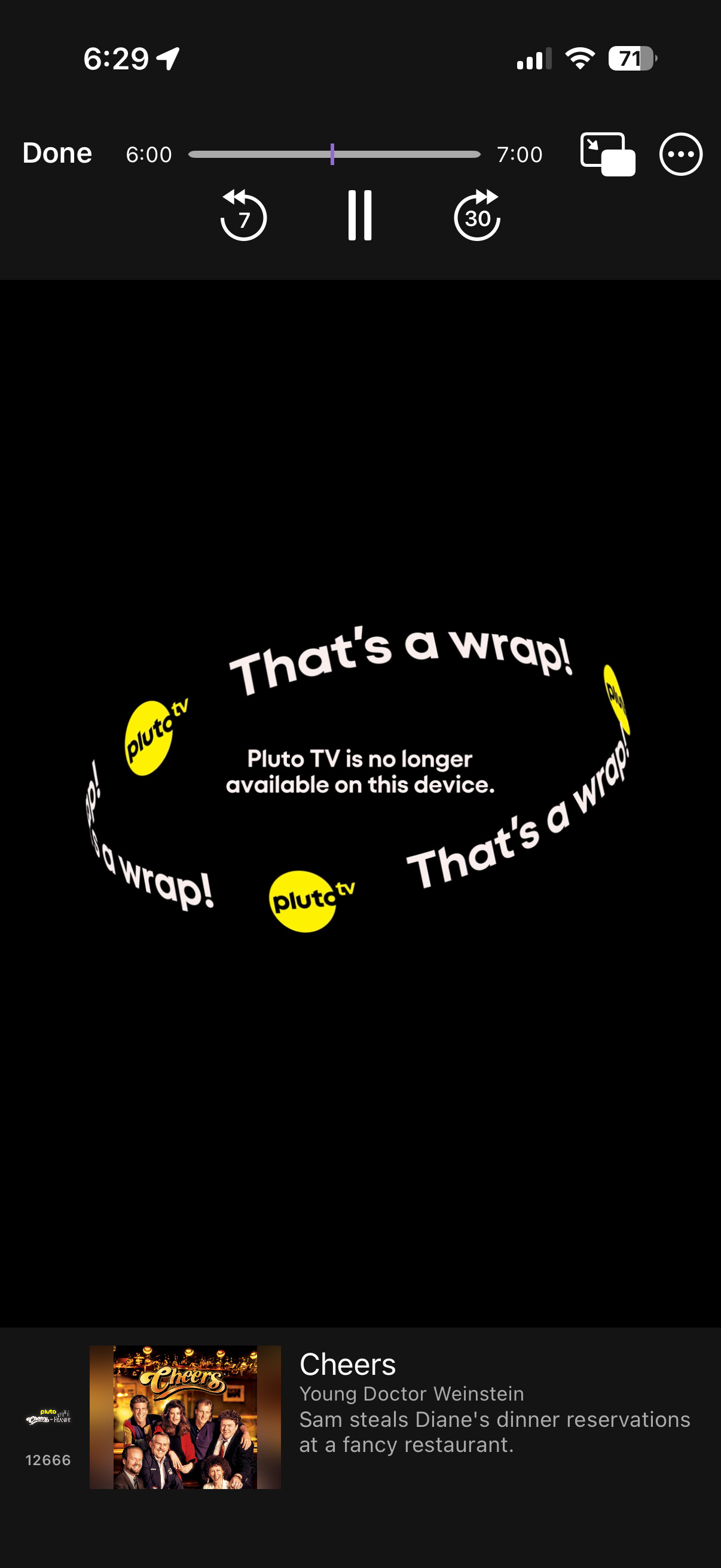

Or post general questions unrelated to a specific Project in Pluto TV On Screen Message "Pluto TV is longer available on this device"
I've been having this same issue since updating to the latest docker image almost daily. I either need to reload the m3u or when that hasn't fixed it, i need to restart the server to get it back.
Hi. jxxaxxys post above to switch to the KineticMan docker seems to have solved my issue. It also has the benefit of only needing one source to support 10 streams. Hope it helps you.
Thanks... I'll give it a try.
Getting this on all of my channels. Using Maddox docker. What can I do to get channels back

@maddox any suggestions for this issue? I also have to reload the m3u every day or two.
Yeah, but it doesn't proxy, and so you're hitting the 24 hour timeout on the session since it's sending out full authenticated urls to Channels.
In short, you really should just move on to one of the other projects. maddox/pluto-for-channels is pretty much over.
And if you're going to go the docker route, I highly recommend KineticMan's FastChannels - FAST Channels aggregator/manager which will allow much more than just Pluto from one docker container.
