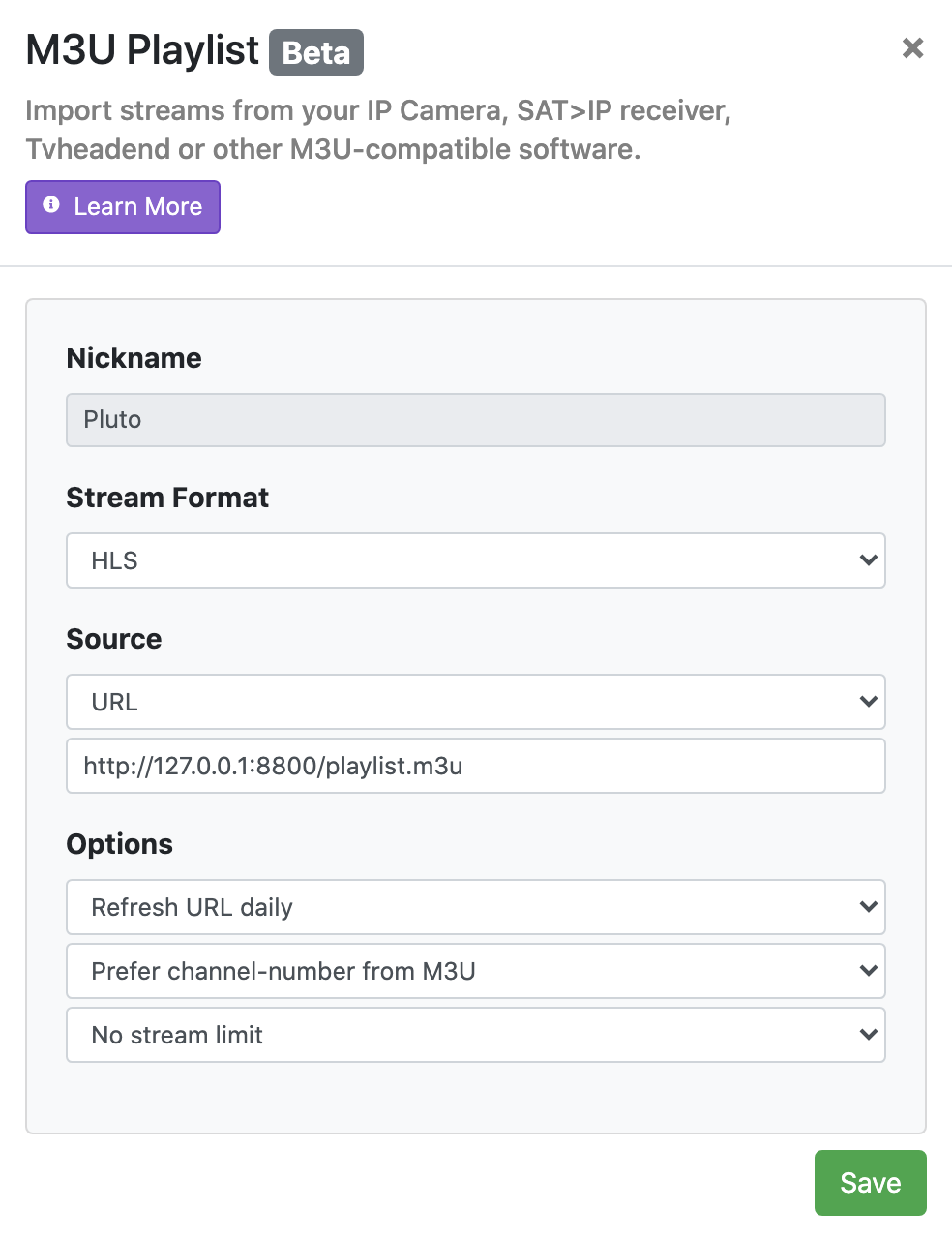

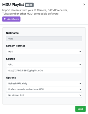

Yes, I added the xml file I believe correctly. I clicked on 'Redownload XMLTV' and the guide populated again like it did after the initial setup. In reading the documentation again, I noticed that it says to download the guide data every 6 hours. I think I left it the default which was to download daily so I changed it. I did notice that the documentation shows using the default localhost URL (127.0.0.1) but in the screenshots, it shows an actual IP address. Not sure which is preferred. Here is what my settings look like:
Any suggestions/corrections are appreciated!
If docker and the DVR server are running on the same machine the local host IP is fine. Your issue was probably due to the daily refresh setting, now that you have increased the interval I think you might be all set.
