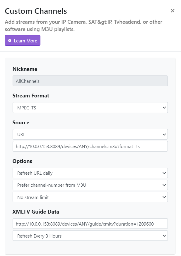

Yeah I just want 1 DVR to have access to TVE Pluto HDHR UNITS ... so below is a screenshot ..... Of my 2nd DVR. I am ok if it is only the search as long as it records correctly. From the Client UI. I guess Channels DVR is not sending all the data from Gracenote when using their XMLTV.

It is what tmm1 said. During XMLTV import, they process the data differently than with TVE sources. Even though DVR1 sourced the TVE data from Gracenote, DVR2 processes all its channels (including TVE) via XMLTV import. Thus, all DVR2 programs have the same issue as DVR1 Pluto programs.
That's why I recommended he do this, until he said he had 3 sources on DVR1.
One way to alleviate this issue is to add tvc-guide-stationid tags to the TVE channels from the first DVR to the second. That way the guide info is maintained on the second DVR, and you don't have to worry about XMLTV translation/mapping issues.
