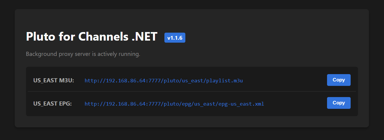

I re-downloaded the current version, in case the download was damaged; that made no difference. Then I downloaded the previous version (1.1.5), and it is working: I was able to paste a m3u into VLC and it worked - but only on the same computer I run it from. If I try on another pc in my network, it doesn't see the stream. The URLs start with 10.5... I copied your program to the other computer, ran it, and it generated URLs starting with 192.168 ... , which both PCs can access. Is there a way to force it to use the 192.168... URLs?

On the PC that is showing the 10.5... url, In a browser window go to your http://192.168.xx.xx:7777 URL of that PC (assuming it is on port 7777) and make sure the links work on your local network. The server is already listening on it, I just want to narrow it down.
Try this release and see if it works for you. The biggest change between 1.1.5 and 1.1.6 is I updated the .Net framework from 8 to 10. This version is on 8 and I also changed the GetLocalIPAddress() method to explicitly prioritize 192.168.* network adapters.
Yes, just tested that & it worked; replaced 10.5... with 192.168... and both offered to save the .m3u file.
