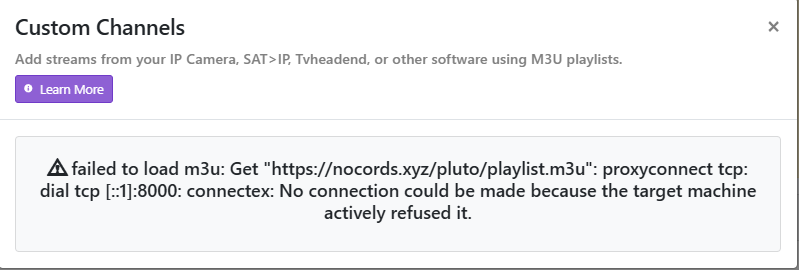

Can you open these links https://nocords.xyz/ and https://nocords.xyz/pluto/playlist.m3u in a web browser?
Windows 11
Yes, it gives me a pop-up to download it. I even put the link into VLC and it started playing. Now I'm not sure why Channels DVR Server isn't picking it up. It was just working recently.
Proxy?
VPN?
None, I never touch any of that stuff. No proxy or VPN is running.
From the same Windows 11 machine you're running Channels DVR on?
Are you running it in a docker container?
Maybe Windows Firewall app access for Channels DVR Server.
Try loading this example m3u from the Channels devs to see if it works.
https://raw.githubusercontent.com/fancybits/custom-channels-examples/main/webcams.m3u
The m3u should load, but only the Platypus Cam channel will stream.
Thanks for the help! I actually ended up giving my computer a restart and it ended up fixing it. No idea what was causing it because I never had any proxy or VPN running, I think something just didn't launch up correctly and was causing the error. I appreciate the help!
