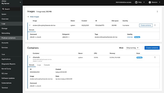

At the most basic level the problem is just that I can’t connect successfully to port 8089 after I run the container. The container shows as running but can’t open the web interface. I also noticed nothing is being written to the /config directory I have set either. Beyond that I’m not sure what else to do to even start to troubleshoot this. I run Cockit and monitor my containers there but there really is nothing as far as logs to help diagnose this. The most I’ve seen from the logs is just “downloading channels dvr”, “running channels dvr”. At one point for whatever reason the logs did say just that it failed to install but that was it.

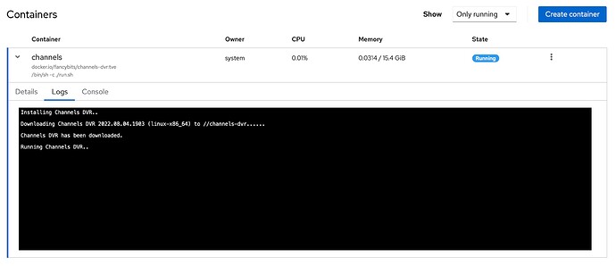

Thanks for tips! I did read a little bit about the :Z, :z labels but didn't fully understand them...I tried what you suggested though and it still seems to be behaving similar except this time when I ran what you suggested what I was seeing in the log files of Cockpit is what is printed out in the command line...it just hangs at "Running Channels DVR"...

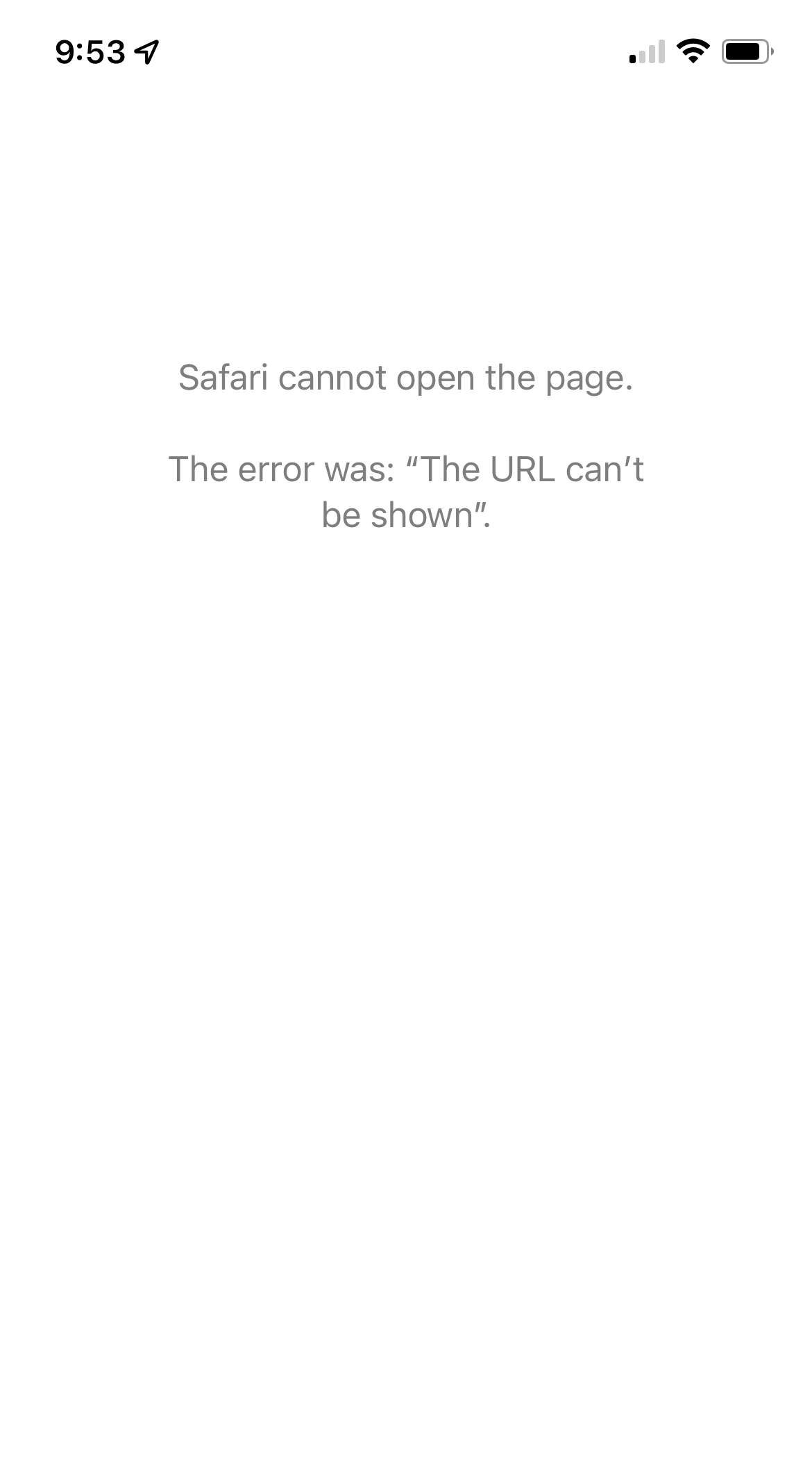

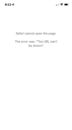

Have you tried accessing it via its web UI?
Yeah I have and it just comes up with…
Port: 8089 correct?
And it was just weird cause when Running it from SSH and just stopped at Running Channels DVR…it didn’t complete and go back to an active terminal…
If you're going to use the run command, you should probably also use the --detach option to les it continue to run and return you to the shell.

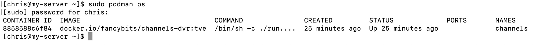

What does the container tab in Cockpit show? Or the output of podman ps?
So it's running ... so the issue looks like it's network related then.
