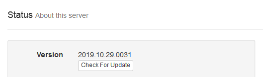

I've checked my DVR version and it says there are no available updates beyond 2019.09.23.2227
I'm on macOS Mojave.
This issue has not been resolved. Just video. No audio to select. Just Closed Captions and that works.
We are aware of this issue. There are some technical hurdles which means it's not an easy fix. It will take us some time to come up with a solution.
P.S. That was the latest "Released Version", until today.
To check for the latest pre-release (a.k.a. Beta) version, you need to click and hold or SHIFT-Click the Check For Update on the DVR web UI. This seems to cause confusion for new users.
