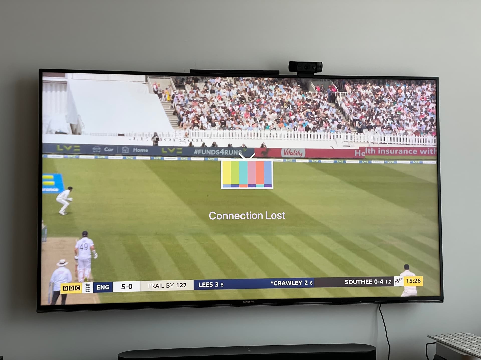

Ok, this problem has now occurred with the HDHR app too. Or rather, I had a much more serious version of the problem with Channels earlier (see screenshot) so gave HDHR a go. Worked fine for about 10 mins and then froze too.
This seems to indicate either a signal or network issue, in that case.
I would recommend enabling diagnostics in your tuner, and posting over in SD's forums. Let them know at which times the error occurs, and they can check the device diagnostic logs (which only they can have access to).
I know you have already done some of this, but since it is occurring in the HDHR app, too, that seems to confirm that it is hardware related rather than software. (Just beware that their support isn't always the best; my personal experience with them has not been good when trying to track and diagnose a hardware/firmware issue. Even when the problem is theirs, they are really quite loathe to admit it.)
I expected the same issue would occur in the HDHR app, because according to the Channels diagnostics it simply stops receiving video data from your tuner. Thus it has no choice to pause and wait for the audio/video packets to arrive.
