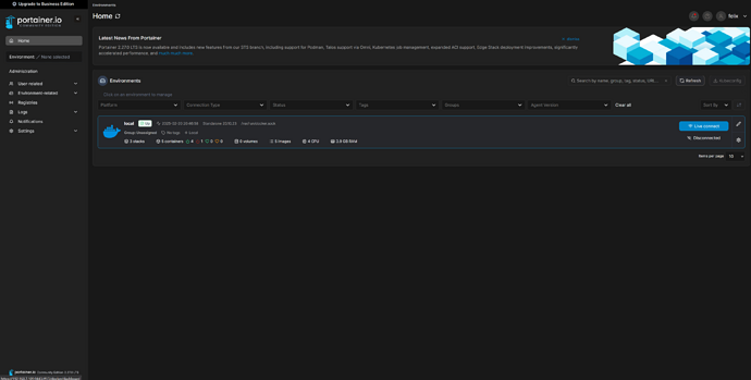

Did you set up an additional environment beyond the usual "Local"?
What do you see when you first login to Portainer? Please post a screenshot.
@sundevilfelix When you first login to Portainer, and you hover over the "Local" environment, what do you see in the lower left corner?
It looks like you maybe created another environment and then deleted it? If you look at the URL in the lower left of the screenshot you posted the "Local" environment has an ID of 3 -- and I've never seen that before, it's always 2. Any thoughts on how that might have happened?
I am not sure, can I delete and redo the stack?
It shouldn't be too difficult for me to create an override ID for the "Local" environment (e.g. to use 3 instead of 2) -- just in case this comes up again. I'll do that in the AM and publish an update tomorrow.

@sundevilfelix OK, so I've added support for a Portainer Environment ID other than 2. Update to the :latest (:2025.02.21), and use PORTAINER_ENV=3.
