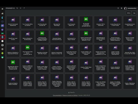

Here's a one minute video I did stepping through Project: One-Click for MLB.tv. If this proves useful, I'll do a few more on subjects related to my projects and Channels Extensions in general.
