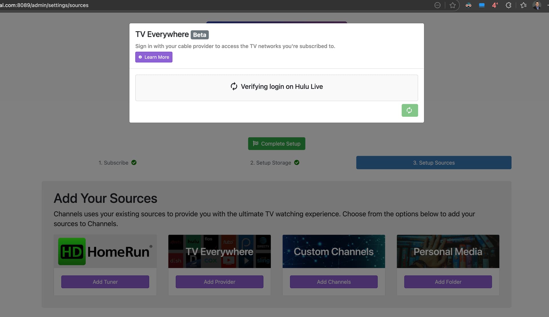

But I can promise that I'm changing the password, verifying it by logging into Hulu with my browser, and using the username/same password when I try to add Hulu as a TVE source.

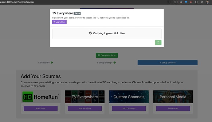

After having some issues with channels not streaming, I removed Hulu as a source, and went to re-add it. That was a mistake. Try to avoid that, even if it means you wait several days to see if a new beta resolves the issue.
I could not add Hulu as a source. I received the 2FA emails, with no ability to authenticate. After trying several things, several times, none of it working, I will tell you how I got going again.

wow, i had this working for a couple of years no issues at all, yesterday i rebooted the NAS - and oops i hit this issue
Given that channels can take a picture of the error message from the embedded web page, is there really no way to make it make a popup for the MFA that can be entered into what i assume is an MFA prompt that is not happening because it is an embedded browser?
