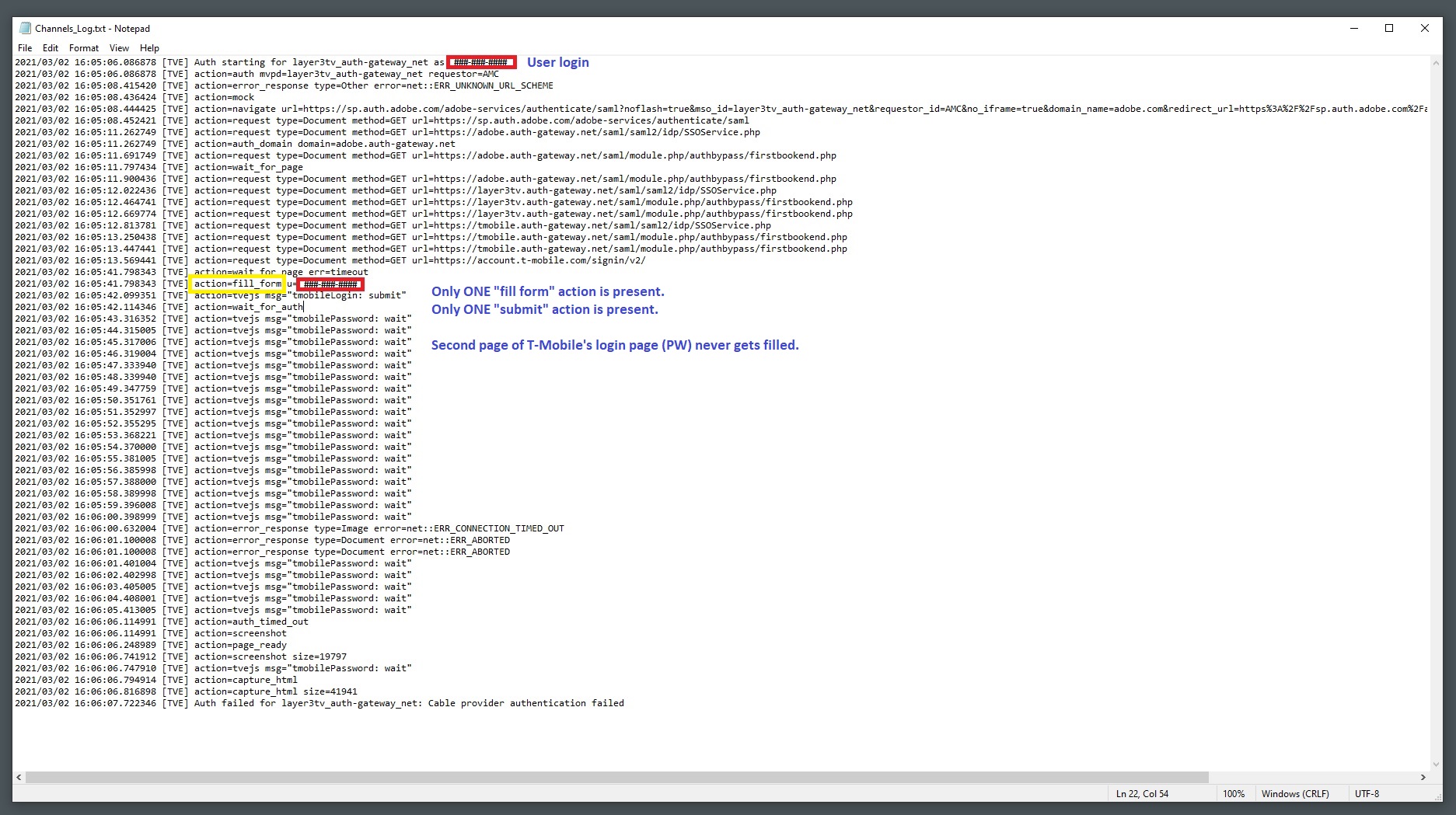

Since T-Mobile has changed to the 2-page/2-entry form of login, I noticed that Channels' code for data entry is incompatible.
Hope my photo is showing...
As I point out in the image, only the FIRST page of T-Mobile's login is filled and submitted.
Shouldn't there be TWO "fill_form" lines of code... one for login (phone number) and a second for the password, THEN the "wait_for_auth" line?
