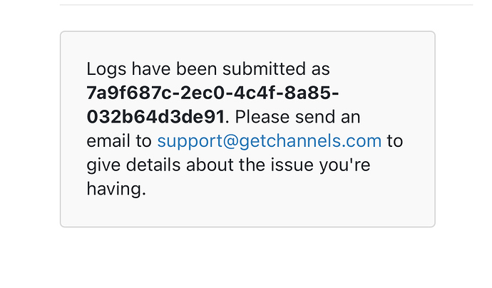

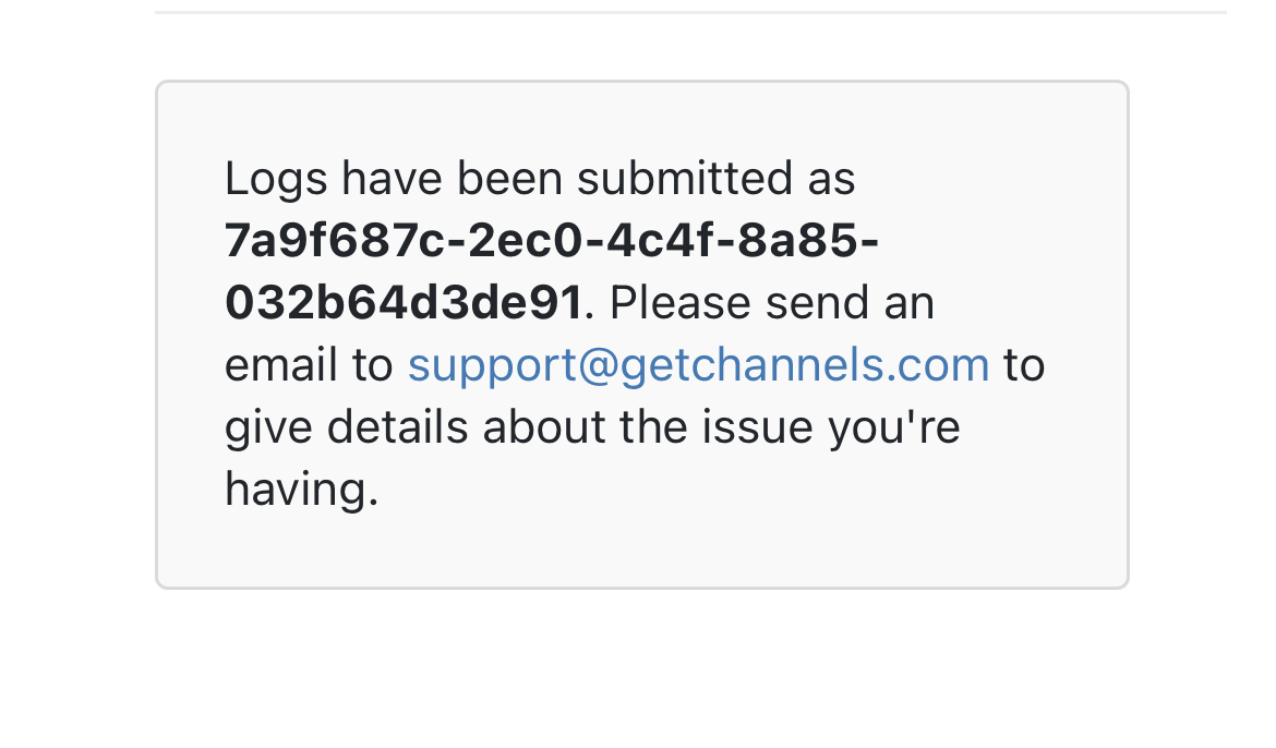

I have just submitted my log. If you want to take a look at my logs and see exactly what it is that allowed me to bypass it while others are having difficulty please do. I have also provided a screen shot of the exact time in my log where I updated to the latest pre release. I added T-Visiin immediately after and it worked. Hope this helps. Also, I know for a fact that T-vision is still improving the service. The Apple TV app was updated today and resolved an issue I was having with location services and local channels. So hopefully this will resolve over time.
Thanks. It looks like a couple channels happened to work randomly but most have the same failure.

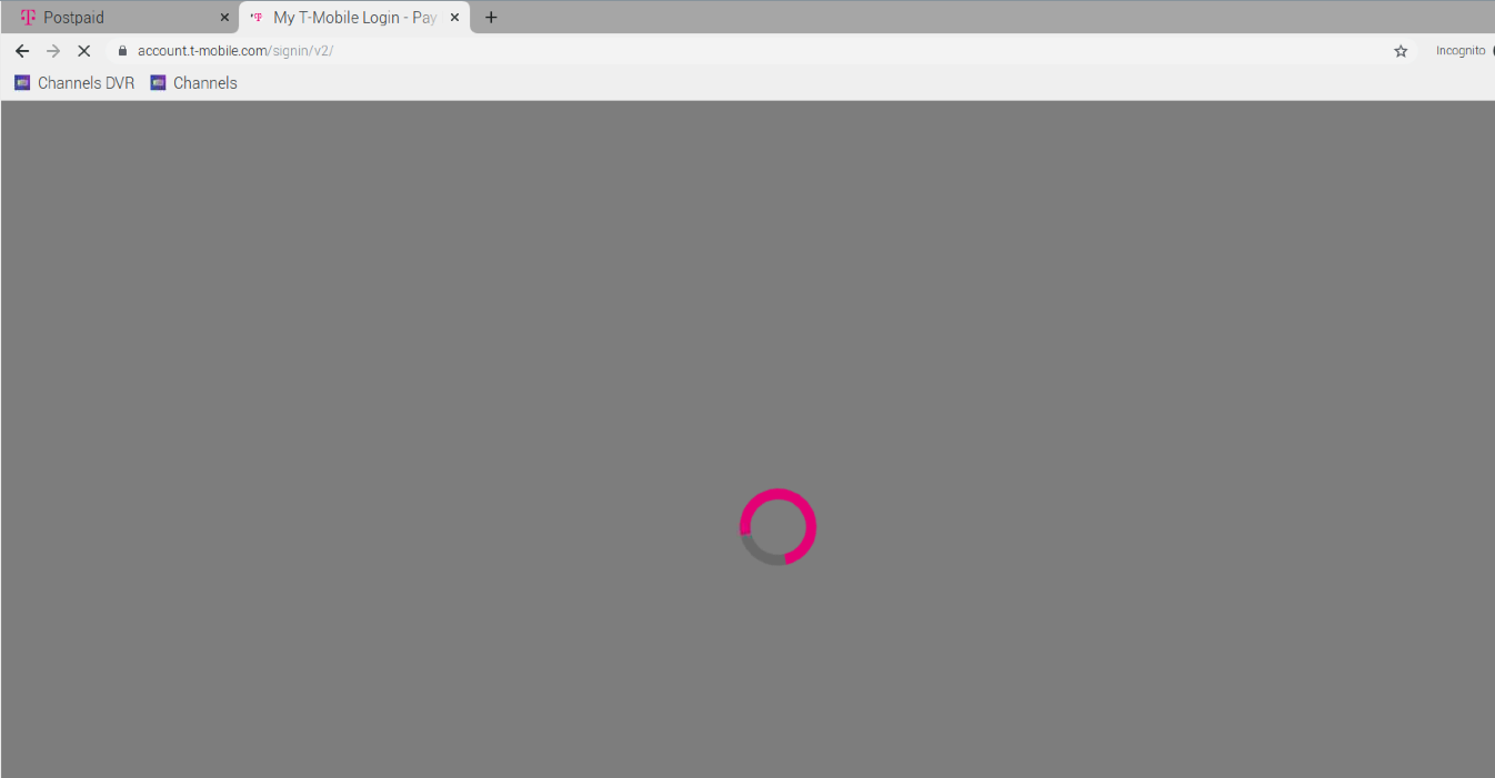

If you look at the third to last log item, you'll see there's a link to https://account.t-mobile.com/signin/v2/ -- this is the last of the redirects from the log in system. When I visit this link and log in with my T-Mobile account through here, I get a spin wheel that goes on for about 6 seconds, which then takes me to my t-Mobile Dashboard:
A regular log in through T-Mobile.com does not take 6 seconds from the time I submit my credentials -- it takes a second or two at most. After realizing this I logged in through https://account.t-mobile.com/signin/v2/ in an incognito window and realized that if I click anywhere on the screen when the wheel is spinning, the log in does not take 6 seconds -- I am redirected to my T-Mobile dashboard immediately without the wait and without 2FA. This makes me think that for whatever reason the log in system used by https://account.t-mobile.com/signin/v2/ is not the same / has different settings than the log in system used at T-Mobile.com.
