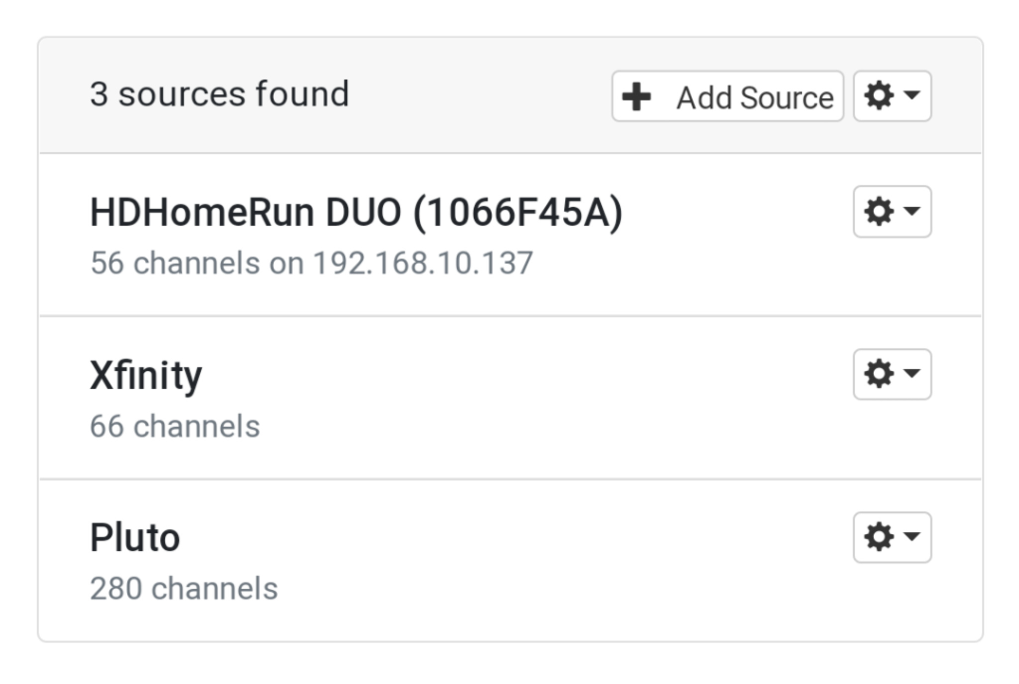

Here's all the channels I'm currently not getting that I should. I've provided pictorial representations for dramatic effect. Pretty good chunk of good channels not working there, but hey, qvc, and the news from distant cities, just great!

Listing channels, is irrelevant really, since all channels powered by Xinfity would not work.
The only time a channel or 2 may still stream is cause the auth is cached and not yet tried to re-auth.

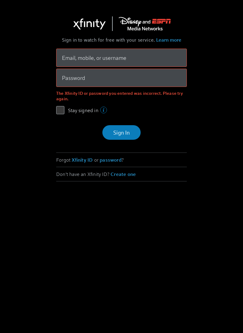

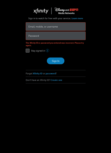

When i go to https://login.xfinity.com/login in Chrome, it accepts my login username and password just fine., however, it then loads the home comcast page, and has the Sign In in the upper right, so it appears it is not signed in. Clicking sign in, just reloads the same page and then it shows i am signed in.

Copying the sp.auth.adobe link for the sign-in page, signing in results in a blank page with the text SC 404. Going to assume that's their weird 404 page. In that case, is there not a better page to get the auth token from?

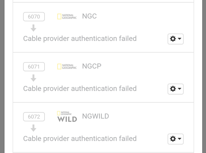

These are the ones not working all others are working fine ....
6030 CNN
Cable provider authentication failed
6031 HLN
6032 CNNI
6037 TRU
6038 TRUP
6039 TCM
6041 TOON
6042 TOONP
6070 NGC
6071 NGCP
6072 NGWILD
6080 FX
6081 FXP
6082 FXX
6083 FXXP
6084 FXM
6090 HALLMARK
6091 HALLMARKMM
6092 HALLMARKDRAMA
